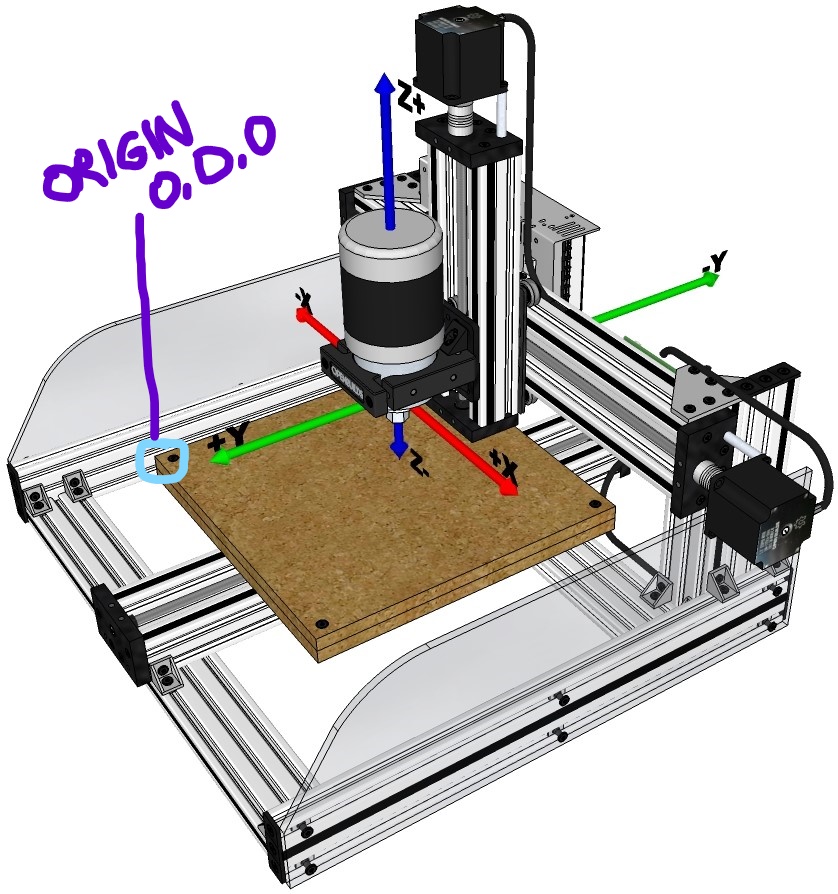

    Ok, so no video (technical issues). But I did notice that my y is not working like it should. My understanding was that home is X0, Y0, Z0 like such (coordinates hyperlinked to image). When running the running the sample code provided on openbuilds website for the y axis is reversed also the x axis.

    Notice the origin location in my marked up drawing. When you press "right arrow" key the X axis will increment in the positive direction for tool output (which is actually moving the gantry to the right). "Page Up" should move the tool up, away from the table surface. When you press the "up arrow" key the Y axis will increment in the positive direction for tool output (which is actually moving the Y table toward the front of the machine, since the X-Z gantry can't move away from you). This gives you positive tool output as expected and is correct.
    In your image, the X-Z gantry is able to move in the Y direction, instead of the table moving in the Y. If you were build a machine with this kinematics, your Y wires would need to be reversed from mine. The C-beam machine has a disconnected, independent Y-axis so it's movement, relative to X-Z, is reversed when compared to the kinematic system your picture shows.
    I hope that helps.

    When manually jogging the system, it moves in the correct directions. Alternatively when running a program supplied by openbuilds the directions are randomly switched ( - direction becomes +) either by X axis or Y axis. How do I fix it ?

    I haven't tried the OB samples, so I don't know if they work properly. I would say if you are jogging correctly, you are probably setup properly.

    My guess is that the machine that Gcode was generated for, had its grbl settings different than what you have for your machine. So, if it was for a moving gantry machine like the ox, and yours is similar in function, it would work. If you are using gcode from the C-beam Machine on an ox-type machine, things could be different. The quickest and easiest way to see if yours works the way you need it to work for stuff you create would be to try to make your own Gcode for something simple you design. Use your CAD/CAM software to make a simple 50mm x 50mm square with the X0 and Y0 at the lower left / front left and cut it out of scrap piece of plywood slightly larger. Place this material in the center of your bed. Zero X and Y on the at the lower left/front left of the material and try cutting. Take a video showing your set-up and cutting. This should give you a margin of safety to stop before something crashes and it is simple enough to figure out what is wrong if it cuts the wrong way. I would send you the gcode, but I do not know your machines parameters. This took less than 5 minutes to do so it would be better if you made your own since you would need to know the thickness of your available material.
