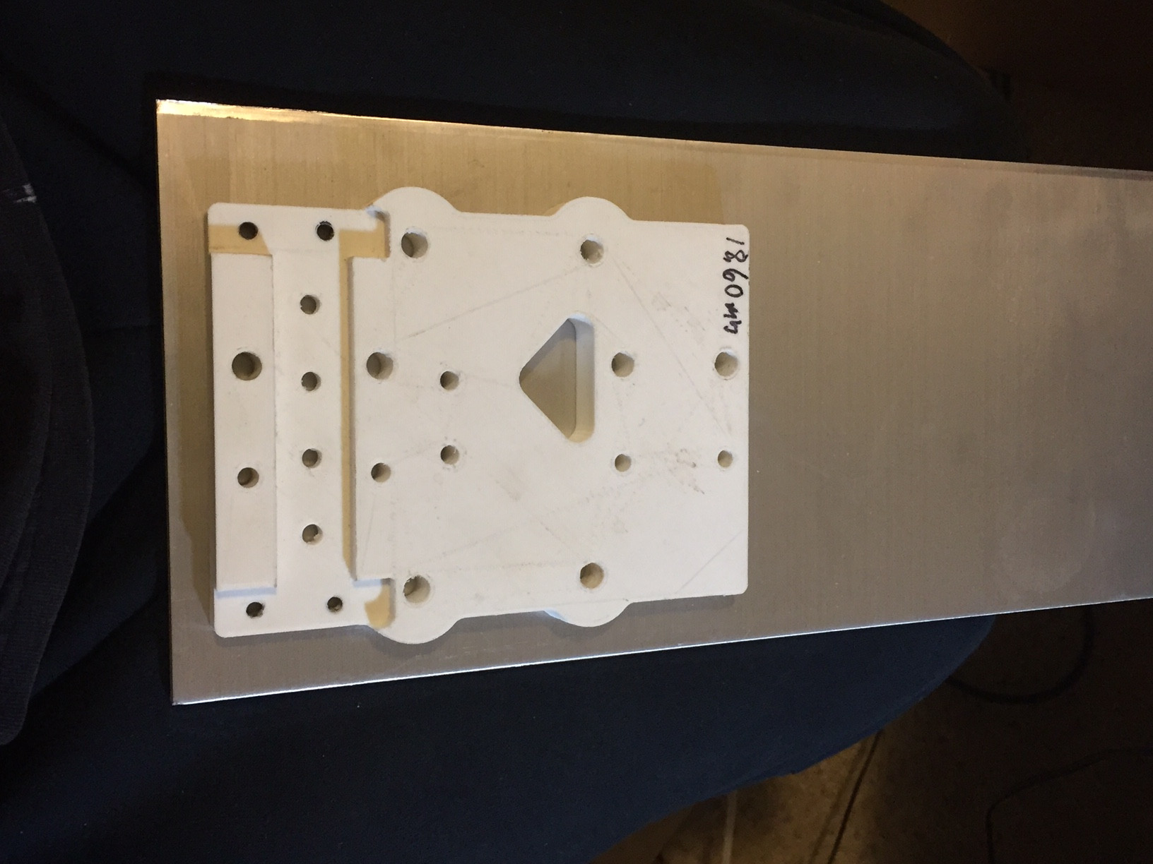

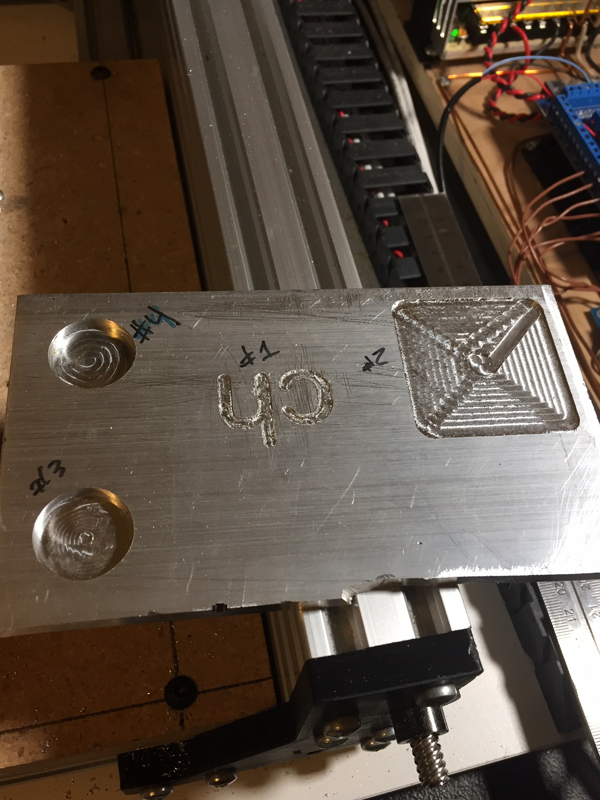

    Updated learning process so I have tried to cut aluminum. #1 cut 3d Printed z plate acouple pics down "ch" used 2 flute endmill. The z plate was working for cutting acrylic and I knew it would probably would not work with aluminum but I had to try. It bounced around and look horrible. So tore it apart got a piece of aluminum placed old z pate to the new piece and drilled all the important holes to rebolt it back on.
    Now I have a pretty rigid Z plate. Bored some holes and cutting out pockets.
    500w spindle
    Cuts #1 and #2 are with old z plate. 2 flute 2mm endmill.
    Cuts #3 and #4 are with new z plate. 3 flute 4mm HRC55 endmill

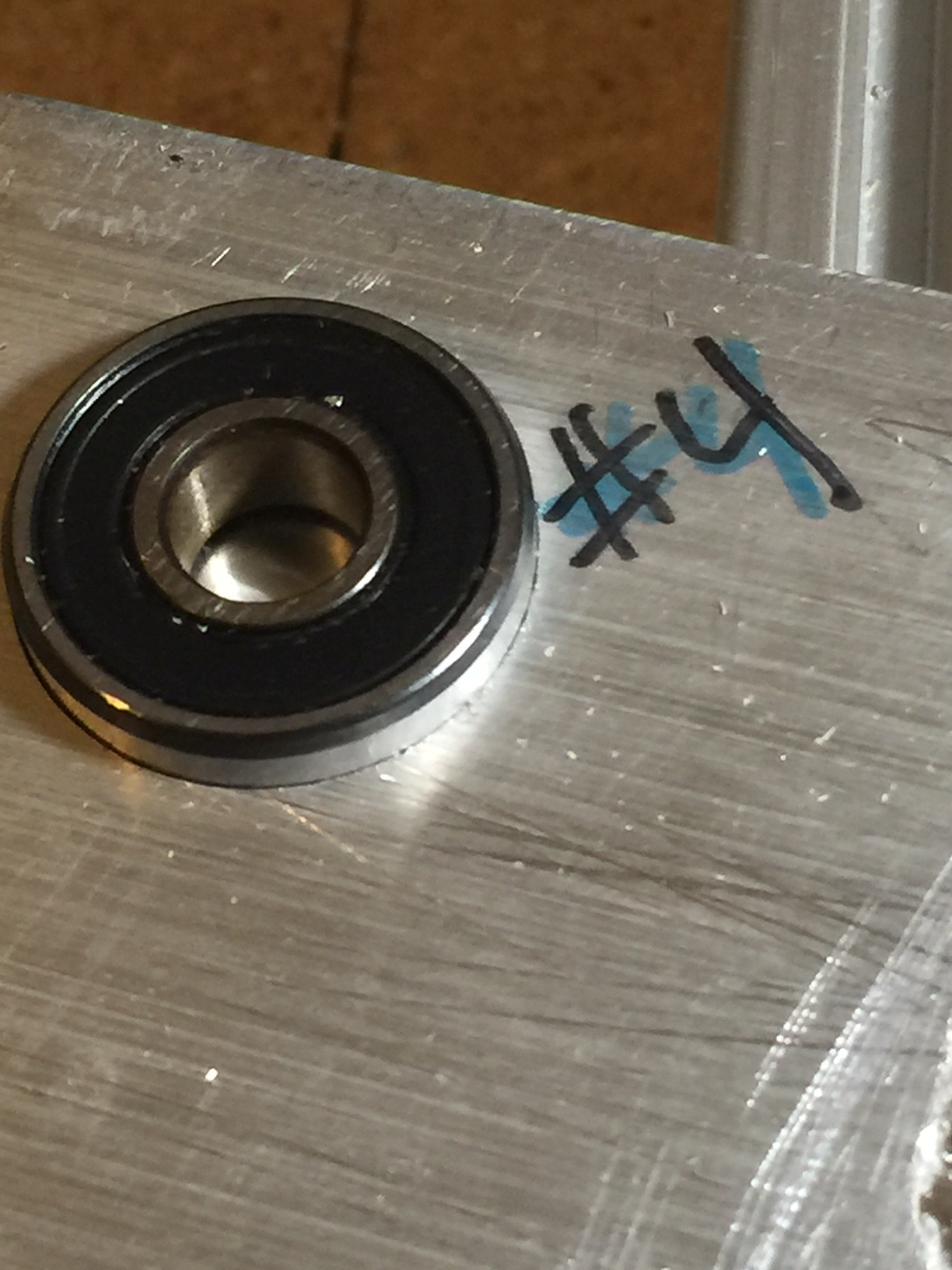

    I pocketed cut #4 at 22mm to fit a bearing I have that when I used digital calipers it measured out to multiple tries 21.95mm. And the bearing fit just snug it drops in as long as it level and flat it wont go in crooked with a slight movement laterally in the hole. Im thinking of taking the pocket smaller to almost having to heat up maybe or a vise to press the bearing in. My goal is to redo my 3d printed motor plates on both ends of the Y axis with the sealed bearings. I bought them for another project but ended not using them. This just testing the waters with sizing of holes to dial calipers. I have experience with my 3d printer if I needed a hole for 21.95mm bearing I had to draw the holes 22.2mm for the bearing to fit. SO I perceived that to be a pretty large margin of adjustment to make.
    "After calibrating my cnc router would you say .05mm is close to being calibrated or would you take even closer then that?" when I placed the dial calipers in the whole to get measurement dia of the hole it was consistently 22.00, 22.05 in about 5 tries. How close would the professional machinist want the machine dialed too? I am not a machinist by trade but have been excited about learning about this skill. I am thinking of getting anything closer smaller .05mm I would need to measure my routers movement with a digital dial indicator! I did the ruler measurement ran 100mm eyeballed it did the math adjusted in grbl.

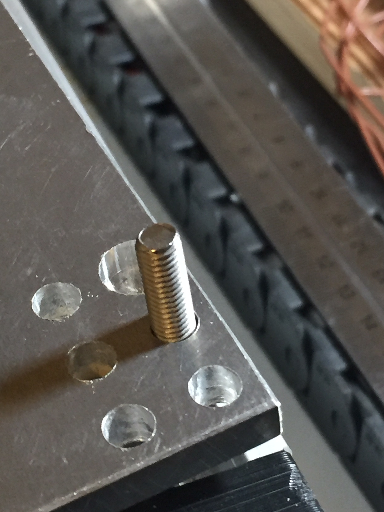

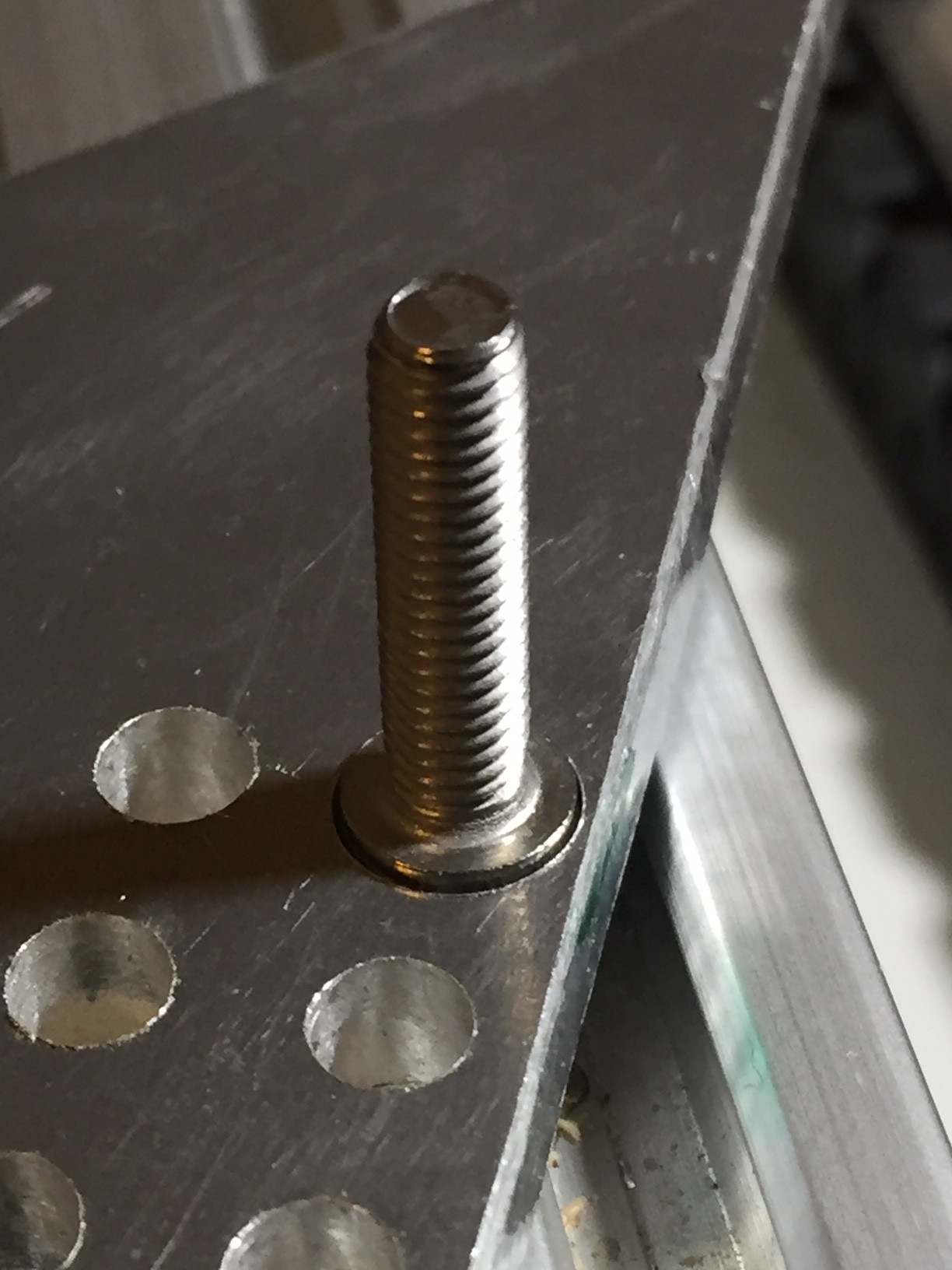

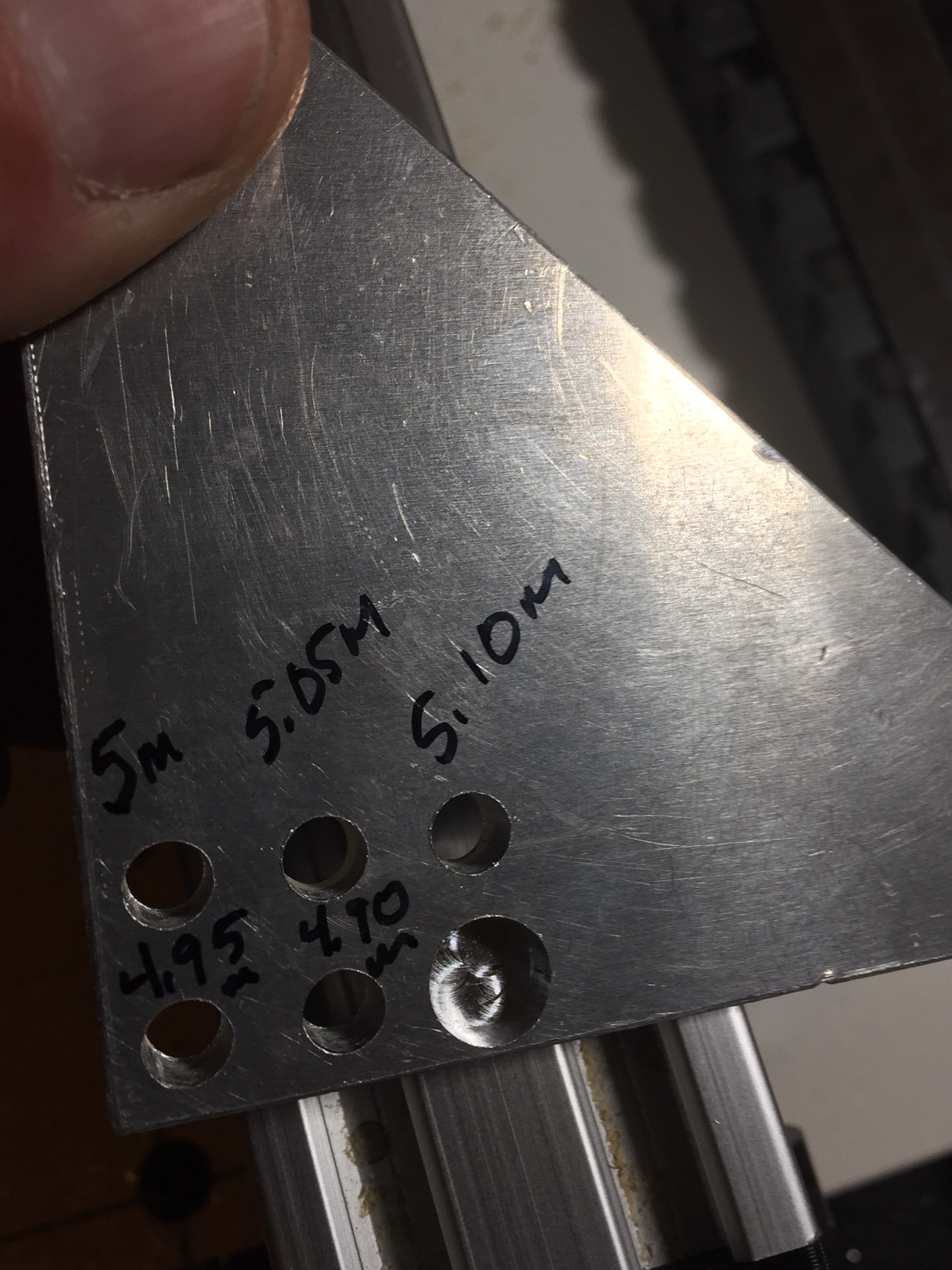

    Also did some smaller holes and pocket for 5mm allen bolts. The bolt measures 8.40 dia head and 4.90 dia on the threads.
    I did a 8.5mm pocket and holes were as marked and they seem to get bigger and smaller as I put the bolt in and wiggled it from 4.90mm was the most snug and the 5.10mm being just a tad loose and holes in between were progressively getting bigger. What I was looking for the router is being consistent at making the holes bigger by .05mm.
    I also wanted to comment about the spindle. 500w and its working pretty good for the few cuts I made in aluminum. Pic above cuts were .25 depth with 200mm a sec. Running it at rpm to max which is probably around 11k ish I haven't implemented a RPM sensor yet. But point being it did cut it, question is how long will the spindle last. My next spindle going to be either 800w or 1.5kw with VFD. I know the routers are a lot cheaper but the noise is the problem for the cnc router is in my back bedroom.

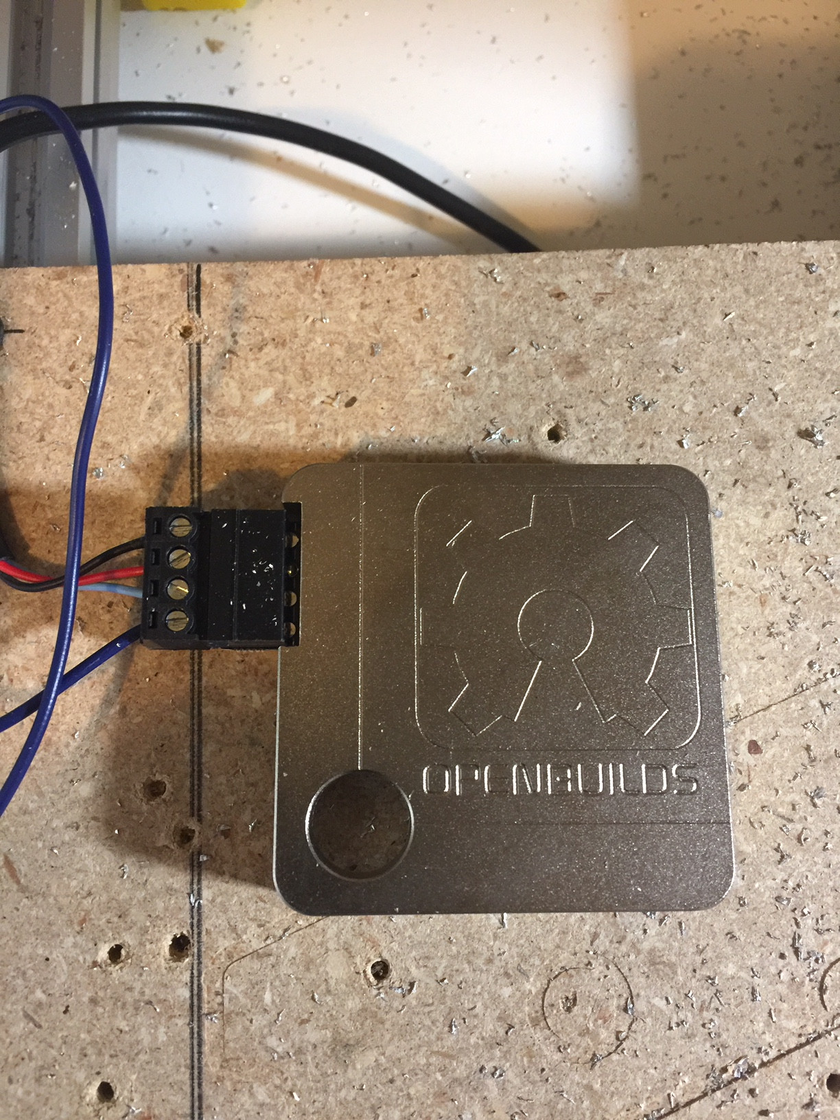

    Oh and I have been using my Openbuilds XYZ probe just awesome! Glad its made out of metal first time I used it I forgot to put the magnet on. That was fun and scary at same time. But I think this is really worth the money. Thanks!

    It looks like you are getting it dialed in for aluminum. One thing I have found is that using the largest diameter endmill you can gives faster, cleaner, and more accurate cuts because there is less flex in the endmill. Another option that helps is using shorter endmills.
    For example, for your 22mm pocket, I would go with a 6.35 mm endmill. I am not a fan of the 3.175 mm (1/8") endmills for pocketing or cutting out a part unless there is a corner radius that requires it. I use them for hole drilling small holes all the time, but for 5 mm holes I was using a 3/16" inch endmill.

    That
    That is good advise thanks. I would like to see how much bigger and fast i could push the 500w spindle.

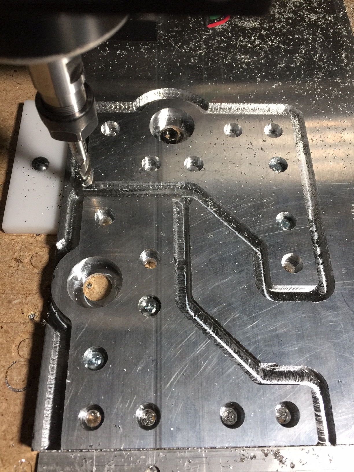

    Ok got scenerio question. This pertains to starting a .NC file and in the middle of running this job I had to stop machine. Now my part is half done so what I have been doing in this situation is I would start the machine over let the machine run over the cuts it already did dry fire so to say. But I am wondering if there is a better way to pick up were it left off.
    So I have been thinking before I try it I want ask. I restart the job that I previously stopped. Let the the bit start moving horizontally as if it was cutting but its dry cutting. Pause the job lower that bit until it barely touches the part path and then hit resume. I know I would have to watch the job close to the end cause if I lowered bit after I restarted job the depth would be off. So I guess the question would be can you adjust the depth of the bit during a paused job?
    Using OpenBuilds Control Software. The pic is a modified Sphinx plate to replace my 3D printed plates and different bearings. But the cut in question is the perimeter cut, cutting part out. Thanks.[​IMG]

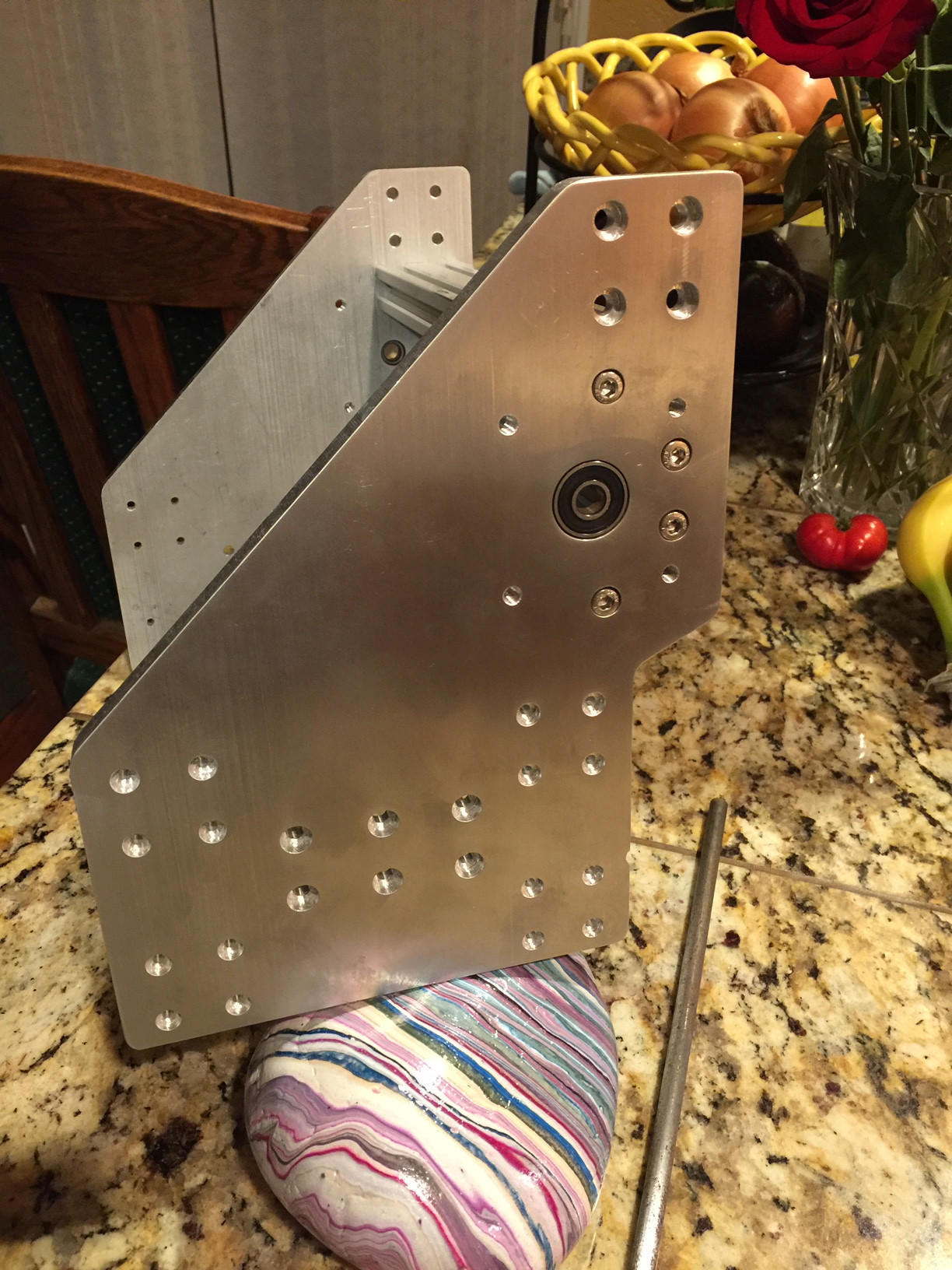

    Ok just got these plates done. 3/8 thick uprights for the Y axis. Designed to swapped out and still use the 8mm lead screw and upto 1 or 2 anti back lash nut blocks with 1/2 in spacer. These are designed with the MGN12H lead rail in mind. Added extra 40x40 Aluminum Extrusion on top of C beam for spreading out support for the Z axis. Gonna follow up with a 1/4 in back plate or maybe steel to tie pieces together like Rob Taylor design been working on these for a couple of weeks. Trying to get them cut, pocketed and bored on current machine.Also both plates had to finish some of the holes by hand. Oh coarse there is always some thing that happens to mark or gouge somewhere on the piece I am working on.
    This was weird not sure how to explain event happened. I was in middle of cutting this plate out. I pause job in OB controls. After about hour I came back turned spindle on and hit resume. Machine started moving it did about a 4mm back pedal then started moving forward again. I didn't think much of it figured it needed a running start from the pause. Untill it got to the corner I wasn't paying attention for about 1 min and then I saw it undercut the corner. Anyways still structurally sound gonna use it. But man never 100% perfect. When the rails get here I get these installed will post files. Thanks!
