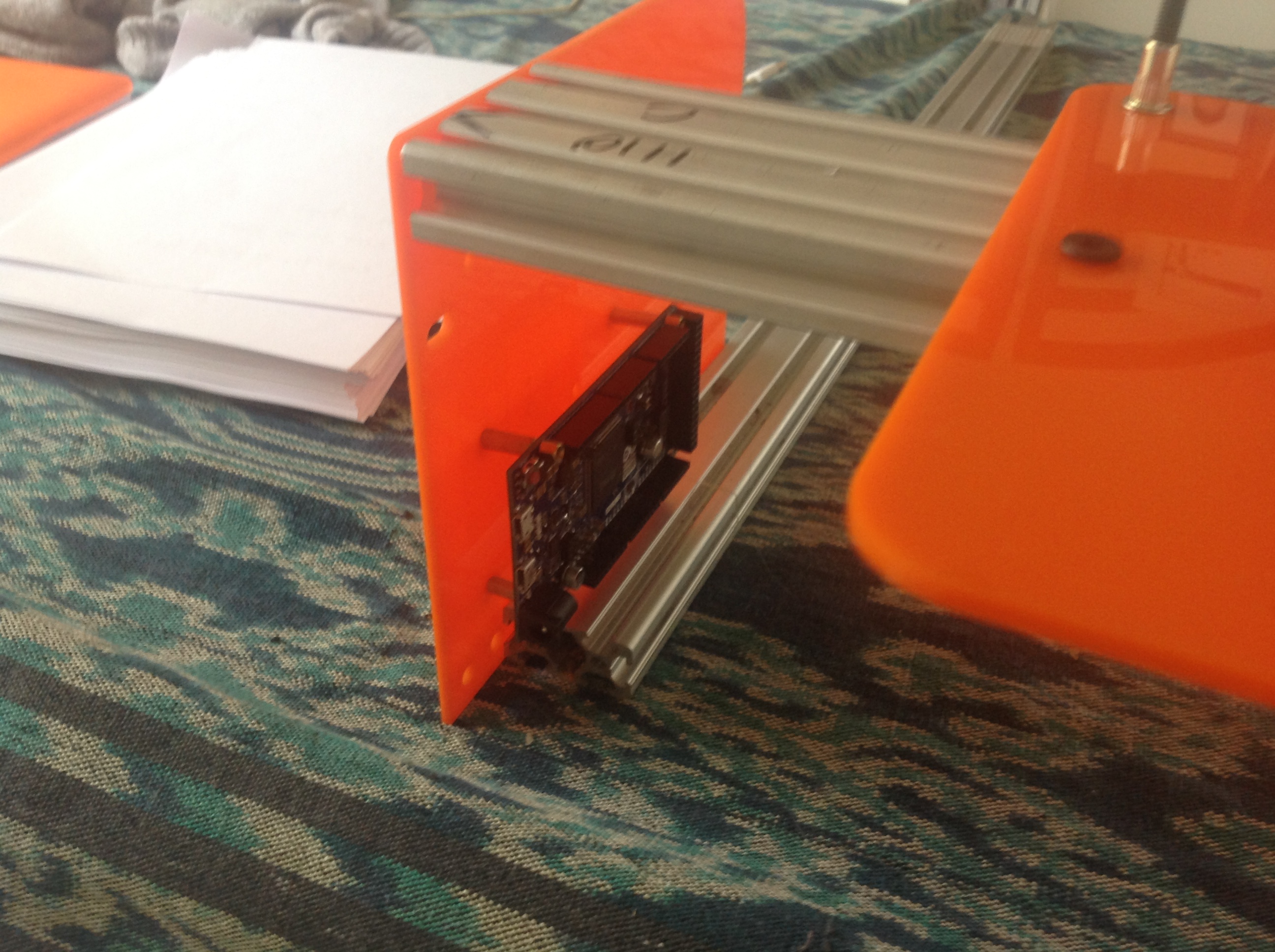

    I just completed the test assembly with some odds and ends of extrusion to prove my design files were OK - all fit, snug as a bug on the first go. Sometimes I surprise even myself! But... there were two errors: I forgot to add the holes for the toothed belt and its tie-down. I did draw it, but sent a previous ver to the laser bureau in my haste to get it cut in time for my wife to bring it on the plane. I'll do butchery with a drill and file for testing.
    And now I can do a full BOM! Yay!!! The mechanical parts list is looking very minimal - 4 wheel sets, 8 washers, 4x 45mm bolts and nuts, 20x 10mm bolts and t-nuts, 6x self-tapping steel bolts (for the 6020/side panel interface), 3x toothed belt pulleys, two NEMA 17 steppers, a few hardware odds and ends, depending on how 'full' you want the build (limit switches, power switch, PSU, etc.), and the length of alloy is dependent on the size you build it.
    The acrylic I used was 3mm cast acrylic, which is a little flimsy for the sides without some triangulation - sadly my courier wife left the large stabilising back piece sitting on the plane, but we should get it in a day or so. I would rather have used 5/6mm, but Ponoko doesn't offer it. I also specified 'orange tint', which would have given me a transparent, laser-safe (and cool!) look, but that isn't available in the NZ store, only the US.
    To beef up the gantry - especially the cantilevered Z-axis, I have used two 3mm plates. There's no appreciable flex, even with a 100gm weight hanging off the mini-V gantry assembly, but without the stiffening back panel, it wobbles around like me on a skateboard.
    In the spirit of minimalism, I cut a bunch of 3mm washer/spacers, rather than have to buy alloy ones and they seem to be working just fine. The y-axis is as smooth as butter.
    I went the ACRO route with sliding v-wheels, rather than eccentrics, again for minimalism.
    Now I've proven the design, I will get them remade in 6mm transparent orange.
    I just used an offcut of 6020 to prove motion - the finished one is ~1200mm.
    Yes, I know there's only one bolt/t-nut holding my end plate/X-axis idler on - I used two long t-nuts and they interfered with the idler pulley. I will put shorter ones on when I do the final fit.
    You can see the Arduino DUO mounted, but without the GRBL shield - I added mount holes for DUO/Mega, TinyG and Smoothieboard. You can mount inboard, like this, or swap the plate to the other side and have it mounted outboard.
    There are holes to put a piece of 2020 across the back to mount the back panel to, but I won't cut it until I am at final assembly. I used the offcuts of 2040, but will use 2020 in the final assembly.
    I used 't-insert nuts' for ease of initial assembly, then put in the correct 46mm bolt and nylock nut to check fit. This is all coming apart again, the t-nuts make it quick and easy to assemble and test.
    Note the additional two plates to beef up the Y-axiz and the 50 washer/spacers, which could be left out if you want to use alloy spacers and 6mm acrylic (or MDF/steel, etc.).
