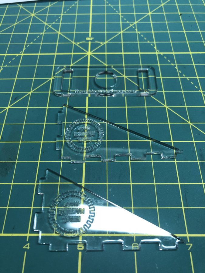

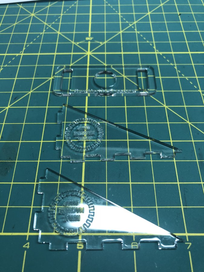

    2F8CC00B-BAE9-401D-B07C-DE3AEF12CC8B.jpeg It works can I put it apart now????
    joetemus likes this.
  25. GrayUK
    WOW! That was fast. Just like that! :thumbsup:
    I'm impressed.
    Go for it.
  26. pedrofernandez

    K40 Whisperer, mirrors came very good align
  27. pedrofernandez
    pedrofernandez Journeyman
    Builder Resident Builder
    May 14, 2017
    148
    220
    A lot to learn about this dangerous machine i got bite just at 10% of power in my small finger, dam that hurts, but i think is a normal way to learn that this stuff are not toys, power settings speeds etc but impressed how this thing cut a 1/4 inch acrylic like a hot knife thru butter "White Acrylic",, i will experiment a bit more with it before destroying it for this great idea
