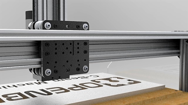

    Hey guys,
    A New Bigger and Badder C-Beam™ Machine is here. The C-Beam Machine XLarge! Let the fun begin...
    Bring on your larger plate and carving projects with this super strong awesome design.
    Many thanks go out to OpenBuilds Resident Builder @Moag ! for working hard to help bring the C-Beam XL Machine to reality.
    C-Beam Machine XLarge Bundled mechanical parts list coming very soon. :thumbsup:
    We know you will love this machine and can't wait to see all the cool projects you make with it.
    Thank you
    Edit - These are the settings I use on my XL machine so I thought it may be good to share them here for everyone to use as an example setup.
    C-Beam Machine XL GRBL Settings - This information can also be used to set up other firmware as well

    That's one awesome plate maker. I can't imagine the days it must have taken to produce all the 3d drawings!! Very well done!

    very very nice. I think I am going to see about swapping around my Z axis so it faces away from the router on my C-Beam.
    I am curious why you only went with 20x40 to fill and stiffen up the gantry. why not use 40x40 and possibly solid plates across the ends to tie the front of the gantry, sides and filler piece? I figure that would help with alignment (assuming all the uprights are the same length) and make things a lot more rigid

    This started out as a 40x40 on the initial test Build that Moag did, but it was hard to reach in to tighten the adjustments X Nut Blocks on the back so we went with the 20x40 to keep the sniffer there but really its purpose is to carry the cable chain so its nice that it can do both :)

  13. MaryD
    MaryD OpenBuilds Team
    Apr 13, 2016
    649
    639
    BETA BUILD!! SNEAK PEAK!
    Well underway. Still needs the MDF.
    This is a shot of OpenBuilds Team Member Keith working on what appears to possibly be the Z axis. That build manual looks amazing.
    snokid, silopolis, Charlie B and 2 others like this.

    Thanks @stargeezer and yes there's just a few 3d drawings ;)

  20. Mark Carew
    2,745
    2,412
    Clean Bundle Build complete! (thank you Keith :thumbsup:)
    13 hours to complete and weighs in at 70lbs.
    Keith is a new Builder and he went right though this Build without a hitch. This is a true testament to the great job Moag has done on this Build manual. :thumbsup:
    Finalizing the details on the C-Beam Machine XLarge Mechanical Bundle now. Hope to release soon.
