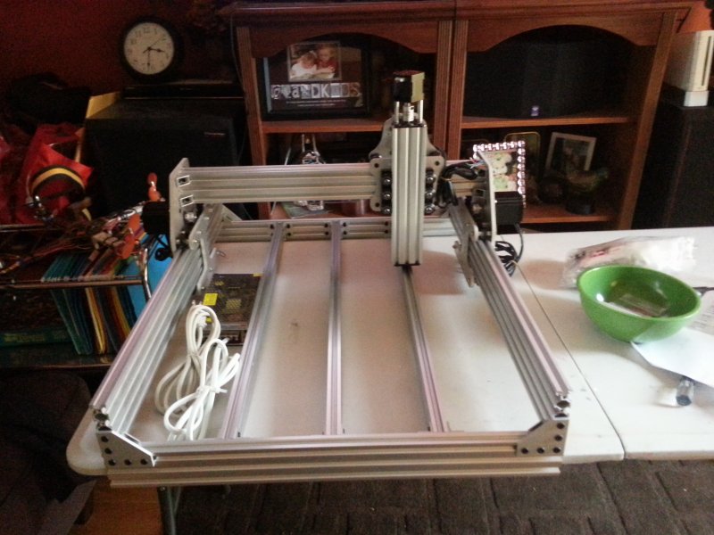

    Yes i got most of the kit. I was sicker than crap last week. I'm happy with my purchase. They did some nice things with the plates the extra support for the x axis is a good idea. Three support beams for the bed is nice also. Waiting on the z axis nut and driver board. Told me it will ship in the next week.
    Before i bought this i tried to order from the openbuilds store for a couple of weeks but something was always out of stock so i figured this way 1 order and that was it.
    I have a 3d printer that i ordered from different places and i still dont have it together because stuff just doesnt fit. Once this is running i can make the last piece i need to finish it.
    Bob

    Nice kit.
    X axis plates are a good idea. Removes the problem of cantilever torsion on the plates and wheel screws and turns it into more of a distributed load. I'll definitely add this upgrade to the list.

    There are a few things I will upgrade right away.
    It didn't ship with a drag chain but so far I don't think it needs one. They have moved where the control board mounts so the only thing you need it for is the z axis and the router cord.
    power supply it shipped with a 12v power supply, I have already ordered a 24v supply.
    The router is a harbor freight router, I'm going to buy a better one as soon as I get it running. I guess I might give the harbor freight one a chance for a little bit.
    I ordered a e-stop switch, not sure which way I'm going to wire it yet cut power to everything or like a limit switch.
    Putting it together was easy but you need to watch both Mark's video's and the ones from spark-concepts. I built it in 2 nights about 4 or 5 hours in total. A couple of things weren't in either video but were easy to figure out. The control board mount uses m5x8mm bolts just a FYI....
    Ok would I do it again.......
    I don't think so. The main reason I bought this was the parts store was always out of stock of something when I tried to order everything to build an ox. But spark-concepts is just getting started and I think they are swamped I ordered this in mid October and got it mid November. I could of placed a couple of orders from the parts store and got it in about the same time I think....
    I have had some people tell me it's overpriced but I really don't think it is. I don't have a chop saw at home I have one up at my cottage but it's 3 hours away, so I would of had to purchase a chop saw for home to cut the rails, that alone would of made buying the parts more than the kit...
    Bob

    I like the inside braces on the Y axis, should really stiffen it up.
    I will be adding that feature but a little different in order to block the chips and dust missed by vac.
    Going to use red cast acrylic, I just hope it works out the way I'm hoping it does lol

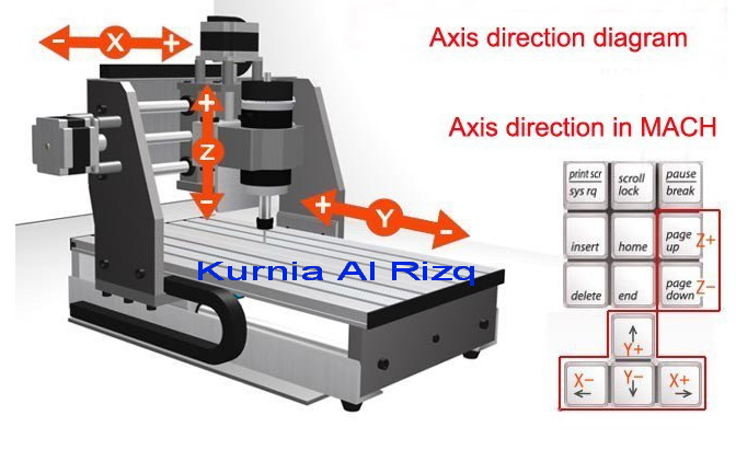

    I find it so odd that everyone around here refers to the longest axis as Y. Must be a router thing. :/
  15. GrayUK
    Joe.
    It does have a History. However, it does not refer to length of axis.
    It seems to be:
    Forwards and Backwards, irrespective of distance, is "Y Axis".
    Side to side, or a cross (X), again irrespective of distance, "X Axis".
    Up and Down, "Z Axis".
    I'm sure someone has explained the reasoning before, I think it was Tweakie.
    Gray
  16. Joe Santarsiero
    Joe Santarsiero OB addict
    Oct 30, 2014
    902
    196
    It's more about what one considers the front of their router.
    In General and for most cases, a mills X axis is longer than it's Y. Feels right to me to view the router the same.
    I was just saying that sometimes it gets confusing when reading some posts because it is not always clear what they're referencing.
  17. GrayUK
    I think the above is the accepted standard in the world of CNC.
    Gray
  18. Joe Santarsiero
    Oct 30, 2014
    902
    196
    Been that way on every machine I've programmed. Also, when the first rotary axis is applied it is usually A about X. Except once I used a horizontal with a tombstone and that was programmed about axis B.
    So this is why I get confused when some folks call their traditional X axis Y and visa versa.
  19. mybuild14
    mybuild14 New
    Mar 20, 2014
    23
    Hey guys this is what I go by when assigning my axis identification. Is this right or wrong?[​IMG]
    #19 mybuild14, Dec 10, 2014
  20. Robert Hummel
    Robert Hummel Custom Builder
    Moderator
    Nov 14, 2013
    978
    715
    That is how I do it :)
    mybuild14 likes this.

    Yeah, must be a router thing.
    I'll end up using a Y gantry. Easier for me looking at the machine from the side while sign making.
