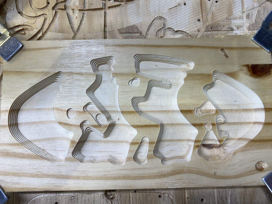

    I just did my first v-carve with the end mill doing a clean out first, and the v bit doesn't follow as close to the material as the end mill, thus not leaving a clean finish, what is going wrong. FlutePlayers-Pic.jpg FlutePlayers-Pic.jpg FlutePlayers-Pic.jpg
  5. Peter Van Der Walt
    14,042
    4,123
    What CAM application, what parameters did you have set up, endmill correctly configured?
    Include the project files if you can, helps to check
