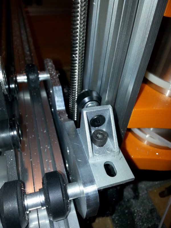

    As I have started using my Ox (Cebu) more, I've noticed some flex in the z axis. At first I thought it was the x axis beams, and was planning to bolt them together. However, it seems like the x axis beams are fairly stable, and the flex is coming from the z axis components themselves. The z axis extrusion with motor on top can move back a bit without moving the x axis beams. The carriage wheels on the z axis assembly are quite tight against the x axis.
    It looks like the flex is coming from the side wheels (three on each side) on the z axis? I only have eccentrics on one side, so the other has the original "loose" fittings with spacers on the opposite. Right now it's too much trouble to disassemble everything to put eccentrics on that side, and I'm not sure it will fix the problem. I wonder if the M5 bolts are bending slightly?
    Anyway, I don't mean that I am dissatisfied with the overall design. It works well, but I've had to change feeds/speeds a bit to avoid (minor) flexing in the z axis.
    Just wanted to start a thread on thoughts. Maybe the x axis beams are shifting slightly, and I just don't notice it?
    For those that have bolted together the x axis, did it make a big difference?

    I have the same issue, I think it a combination of the bolts, bearings and wheels.
    The only solution I can think of is using a piece of channel with the v wheels in the channel and the channel bolted to the x assembly with v wheel bolts through the existing holes. So that the vwheel Botha are supported both ends.
    I bought my ox as a kit from robocutters so I reserve the right to be dissatisfied with his kit as it wasn't cheap. Definitely areas which should have been rectified by now.
    I too was told to bolt the x profiles, which I did aswell as epoxied, this helped initially but soon found that the flex here before was preventing further flex in the z wheels, so with less flex in x more strain went into the v wheels and Inturn the flex lost in the x was regained in the z. Though I think In a bid to rectify the issue the x will need bolting as well as a fix for the z.

    Okay, I figured out a part of the problem. On the Y gantry plates, one of the eccentrics needed adjustment, as the bottom wheel was not making contact with the vslot! Not sure how that happened, in all the tweaking, moving about, wiring, etc.
    Was able to get that adjusted, and it took out most of the remaining flex.
    Unfortunately, the Cebu is now bolted to it's table, and pretty stuck by wiring, drag chain, etc. Tweaking the bottom eccentrics was quite an ordeal!
    -- John

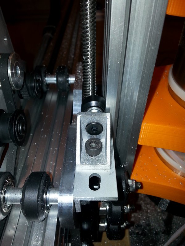

    I have an idea to strengthen the Z axis! I just have to test it and/or design a little something...
  18. Jonny Norris
    Jonny Norris Well-Known
    Aug 17, 2014
    495
    95
    having the vwheel bolt supported at both ends would help massively.
  19. dddman
    dddman Journeyman
    Mar 2, 2014
    468
    187
    Look at this! It will help a lot! Do it on both side :)

    That is awesome! I've been thinking of a way to support the vertical beam from behind, but couldn't find a place to attach.
    -- John
