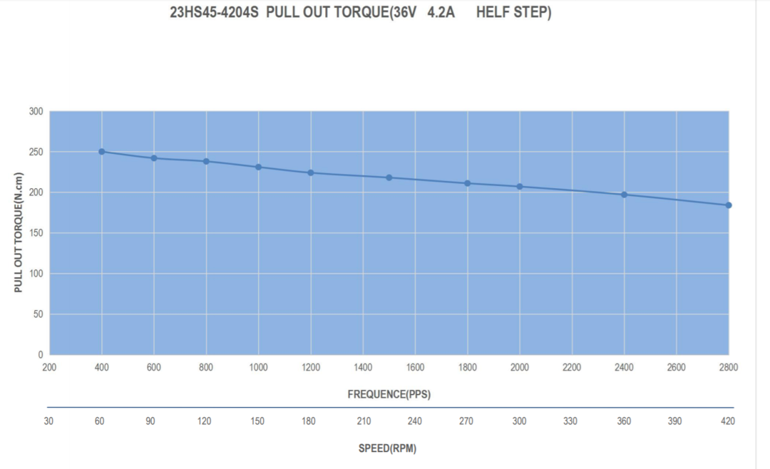

    Would it be ok to run my 4.2A stepper motors at 2.5A. Would that cause them to chatter?

    Hard to say for sure, check the datasheet for your motors, some manufacturers include a torque over current graph in the datasheet. Otherwise trial-and-error. My gut says its too low, you'll be underpowering the motor, and likely get a lot of skipped steps

    I found my torque curve data sheet. But I am not sure I understand it.

    That one doesnt have an axis for current :) so won't tell us much.
    I'd say give it a go if you have the XPRO on hand to test, you can always add bigger drivers if it doesnt work (unless you are trying to save on shipping by ordering at the same time, in which case, get the DQ542ma's - you will never regret having decent power available!)
