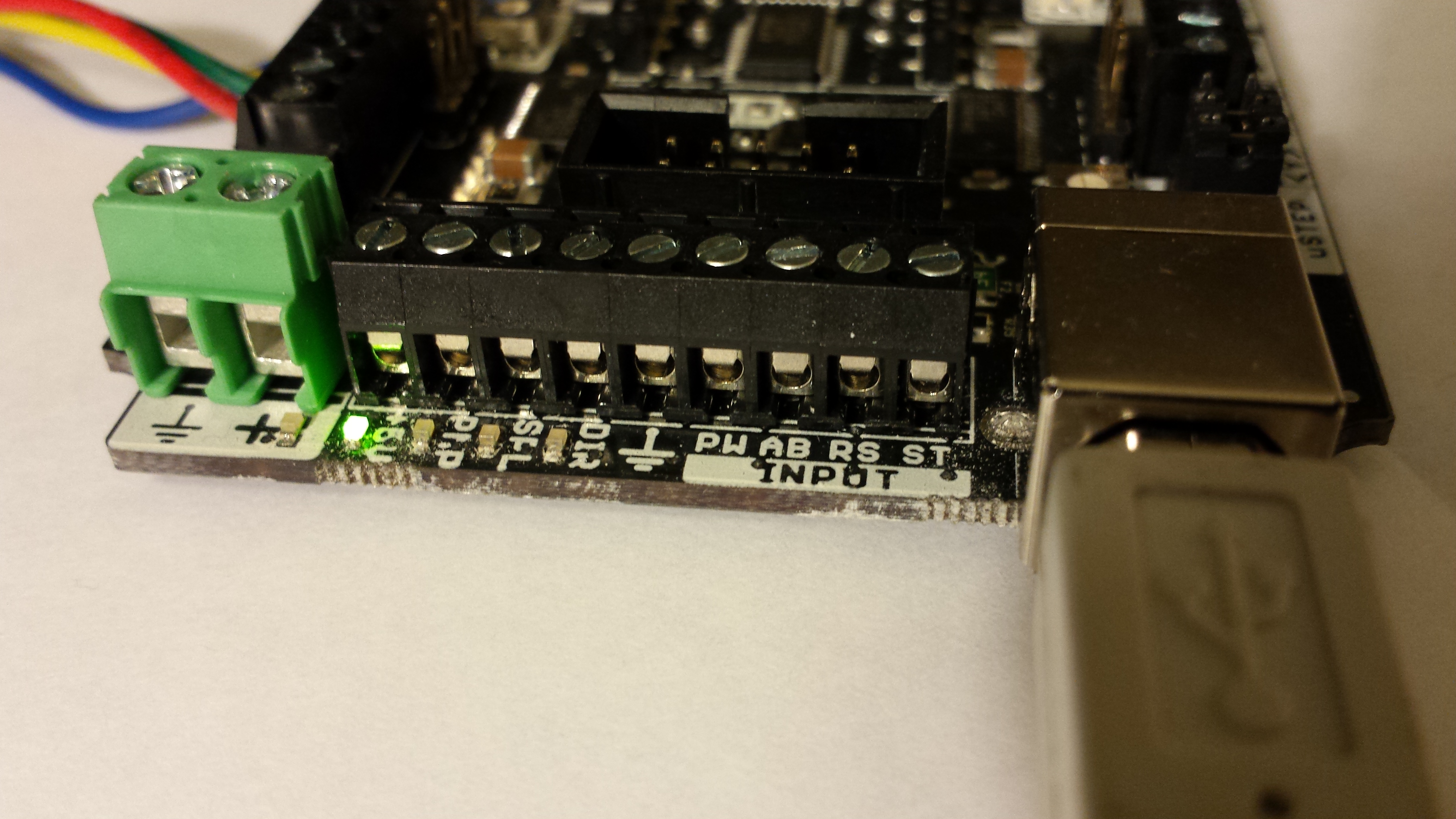

    Hello
    First time here.
    When I plug usb into xPRO board and connect to the proper com port I do not get the grbl settings from the board.
    Some info becomes Highlighted like it connects. But that's it.
    Jeff
  2. phil from seattle
    phil from seattle Journeyman
    Mar 17, 2017
    315
    138
    Got the right baud rate? Is this a brand new board? Try talking directly to the xpro via a terminal program.

    The xPro has an embedded Arduino. So you need the drivers used to communicate with an Arduino to be installed. Take a look at the Arduino webpage and either download their IDE (which installs the right drivers) or see if there is a driver-only download that you can use.
  5. phil from seattle
    Mar 17, 2017
    315
    138
    What program are you using on your PC to talk to the xPro? I like GRBL Panel and bCNC but any of them should work. Look to see if they offer a port. I'm not that familiar with the XPro - the "connection" chime may simply be from getting power, not an actual USB connection.
    Try the normal things you do when debugging a USB connection: switch to a different USB port on the PC, try a different PC, try a different known good cable, verify drivers (check for updates and such). The wiki has a few other things for this kind of situation.
    Try installing the Arduino IDE and see if the board's port shows up.
    By the way, I went to the spark web site and checked their forum - yikes! they'd be better off just getting rid of it.

    You won't see anything in that view.
    I connected a Nano GRBL breakout board to my PC. It uses an Arduino Nano but it's work just the same as any other Arduino running GRBL (like your xPRO). Here's what I see.
    In GRBL Panel you will see a com port (com10 in this case)
    In the Arduino IDE, you will see a com port (com10 again)
    I don't use the gcode sender app but I bet it's similar.

    I use grbl panel with the grbl Sparks Concepts xPro board. Everything was working great until I got this system back from a co-op. Now nothing seems to be working. When I power on the board and connect the usb to the computer and open grbl panel I have 3 options for ports. I try com 10 at both baud rates and the stepper motors complete stepper test and the controls are high lighted but the controls dont move anything. There is no connection because there is no grbl settings from the board either. I tried the other com ports, reinstalled grbl panel, new cable and different usb ports but nothing. I looked up the device manager and it shows com port 10 as usb serial port with the manufacture as FTDI, which I read is the arduino.
    All the stepper motor connections on the board have green lights and the communication port on the board is flashing, which I think indicates it is sending or recieving something.
    At this point I am not sure what to do.
    Can you give me advise?

    I am very new at this as well... Suggest that you download and install Universal Gcode Sender, the interface is pretty easy to navigate, From <UGS>
    Xpro from what I gather is derived from the Arduino UNO . You may need to override the baudrate if the default does not work (either 57600 or 115200). once you use the right baudrate you should get access to all the settings ...and you will be able to communicate with your Xpro, unlike an external drive ...you will not see the Xpro on your computer but you can access it via the Universal Gcode Sender..make sure the USB drivers are installed first...... To review I suggest that you watch the youtube Video as per the link below, Schematix developed the OX Metal CNC Router and did a great job on putting a series of videos together...
