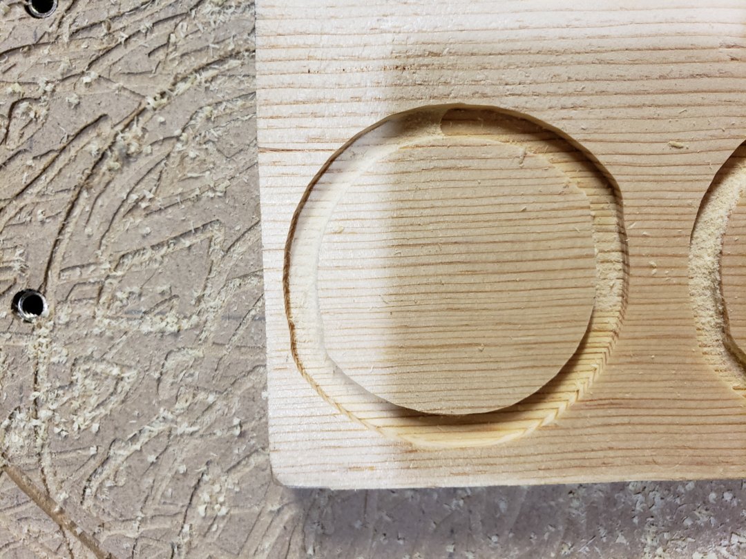

    I just completed my build and trying to calibrate my machine by cutting circles. Having issues (see photos). I have tightened my belts and pulleys and it made it better but the circles are still out of round and ends don't meet. I also performed the X and Y calibrations and they are dead on. I have the Blackbox processor, using VCarvePro, exporting using GRBL inch. Use Openbuilds Control to send to Blackbox.

    As it's not a consistently repeated error the first thing I would check is to make sure the wheels aren't binding. Do they glide effortlessly or not? Are the eccentrics over tightened?
  3. mbkmorgan
    mbkmorgan New
    Nov 28, 2019
    Rick 2.0, That what it was!! The circles are almost perfect. A little more tweaking and I should be good. You guys are the best!! mm

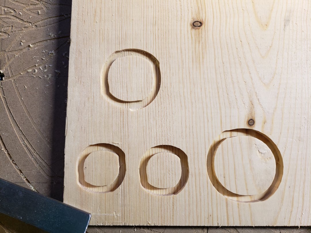

    I am having a similar problem with my circle . 1510 workbe . Belt driven with black box. The same problem is in the same spot everytim . Even when change speed, depth. I have calibrated and look for loose things. Haven't found much but they are better but not perfect. any ideas? 20200216_152221.jpg 20200216_202409.jpg

    Hi @Matt Riberich, the difference between your issue and the first post is that @mbkmorgan's problem wasn't always in the same place and his circles didn't line up at the ends - indicating that the machine was missing steps because something too tight was briefly stopping the motors turning. In your case the machine is getting back to the starting point for each circle - meaning that the motors are turning, but the machine isn't moving. That must be something loose somewhere. What have you found so far, and what result do you get with a really shallow cut - say 0.2~0.5 mm?

    The depth of cut doesn't seem to affect it. Should I be looking on the x,y,or z axis or all of them

    Which axis is which in your pic? If X is left-right then the most likely axes are Z and X. I usually recommend starting at the bit and gradually working away, but you could also check drive pulley fixing to motor - switch power on to lock motor and see if pulley can be moved. Check belt tension. Only someone standing at the machine and wiggling things is going to be able to see what's wrong.

    Alex. Thank you so much for the help. I think it was several thing that was messing with the circles but I think the biggest thing was belt tension on the y axis. I dont think I can pin point one thing due to the fact I took a good part of the machine apart to check things and lower the supports for the spoil board. Just got it back up and running tonight and things seem good so far. Thanks again for sharing your knowledge
