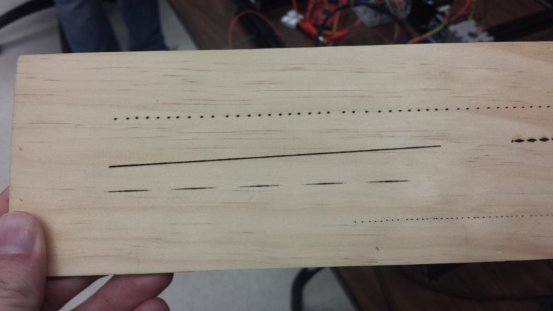

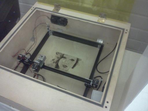

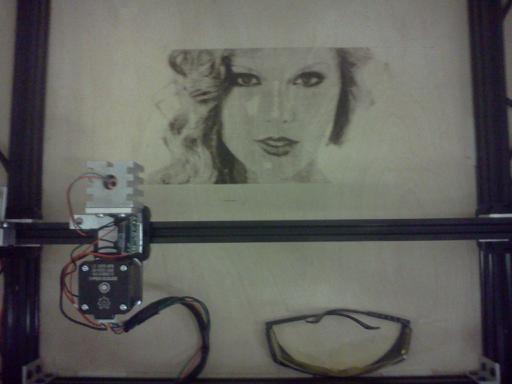

    As you can see, the load on the sled a NEMA 17, but on the other side, I mounted large laser with its heatsink. This balanced the weight on the sides of the sled, but it only encouraged the wobble, and made prints look like hell. See the top row with the wobble in dot height.
    I ended up lining the rail with electric tape to fill the gap. I lined both sides, and the sled felt very tight as a result. If your stepper mototrs don't have enough current at this point, they won't be able to move. If you can't do more current, just rip off the tape from one of the sides of the rail and it should give you somewhat of a balanced improvement. It took about an hour to do. Use one long continuous strip of electrical tape per wheel run, so you should be able to do it with only 4 long strips per sled. See T-Swift for end results. Makes for a nice reproducible setup.
