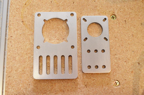

    Here is a video of the Makita RT 701C milling 1/8 aluminum plates for my eggbot built. I could have just ordered the Nema 23 and 17 plates, but I had some leftover 1/8 " thick x 3" wide aluminum plate from my CNC build I needed to use up. Plus this was more fun.:thumbsup: There was one goof. The motor mount slots on the Nema 17 plate were 3.1 mm wide. My cutter settings in Sketchucam were 3.175 so it would not cut the slots. I didn't notice until it was too late. I just put the plate back where it was mounted and lied to sketchucam and said the bit was 3 mm. It worked after that.
    I used a fairly cheap 1/8" single flute end mill (https://www.amazon.com/gp/product/B00EQ1WG4C/ref=oh_aui_detailpage_o06_s00?ie=UTF8&psc=1) at 700 mm/min with ramping set at 10 degrees in Sketchucam. The Makita 701c was set to speed 3 on the dial (15000 rpms-ish). It worked very well. I squirted quite a bit of WD40 while it was cutting because I am out of cutting oil.
    Cleaned up and sanded with 320 grit.
    Right now either Amazon, or Home Depot is selling refurbished Makita's for $69.99 (I think). I got a precision set of collets from Elaire Corporation

    Thanks! The Makita definitely seems up to the task. The final product is clean, and it appeared to have been done in a reasonable amount of time.
