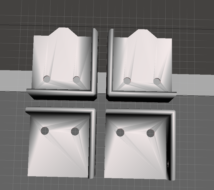

  8. michael macintyre
    Jan 31, 2021
    Hi Keith, I have started using this design and am very happy with it. The only problem I have is the bottom frame has two left hand side corners and no right hand corner at the back. is this something you can easily fix or should i using something like fusion 360 to recreate it. I assembled the other three sides but went to do the back right and realized it didn't fit as it was a duplicate of the left. Thanks Michael

  10. michael macintyre
    Jan 31, 2021
    HI Wilber the link doesn't work if it's this one.
    http://3dwrx.com/VulcanMAX/frame-corners.stL
    Also if you look at the image you can see the back ones are the same. Weirdly though they look like the same but opposite to what I have downloaded from the zip file. For example the download I have has 2 x left sides but the picture thumbnail shows 2 x right sides. Hopefully I have this totally wrong and one of you can say no you have it the wrong way round or something but it doesn't look like it.

  12. michael macintyre
    Jan 31, 2021
    Can you help me because I must be missing something. The rear brackets look just the same both are pointing in the same direction. I can't see how one of them could fit the rear right. Should one not face left and one face right?
  13. Keith Davis
    Keith Davis Veteran
    Dec 11, 2013
    507
    397
    Download http://3dwrx.com/VulcanMAX/frame-corners.stl again. I just flipped one of the rear brackets

  15. michael macintyre
    Jan 31, 2021
    HI Keith, It should be like the attached. I edited it myself.
    It's not great but it prints fine.
  16. JustinTime
    JustinTime Veteran
    Dec 18, 2013
    762
    254
    You print once the original .stl file that Keith posted. After that you flip/mirror it in the slicer software, as Keith suggested, and reprint. You now have 8 pieces! You need 2 of each and you have a spare set for just in case!
