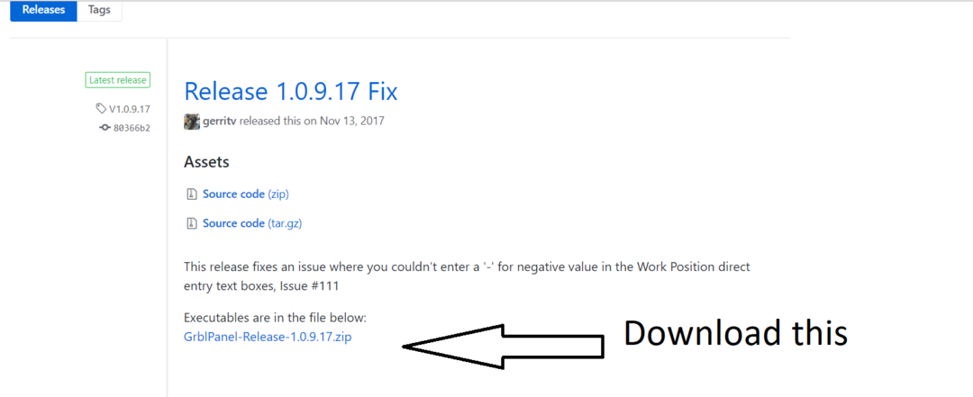

    Did you download grbl-Panel here?: gerritv/Grbl-Panel
    If not, download the GrblPanel-Release-1.0.9.17.zip file and unzip it. The executable is within. Note: This only works on windows. (If you have a Mac, you might try UGS-Platform instead.)

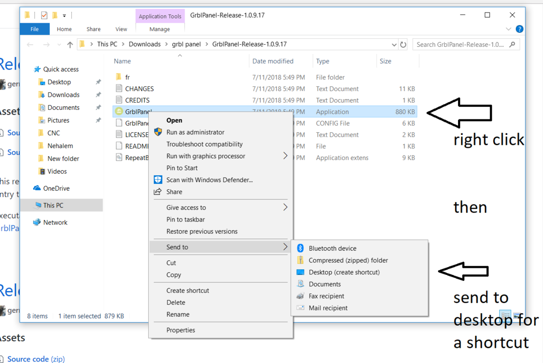

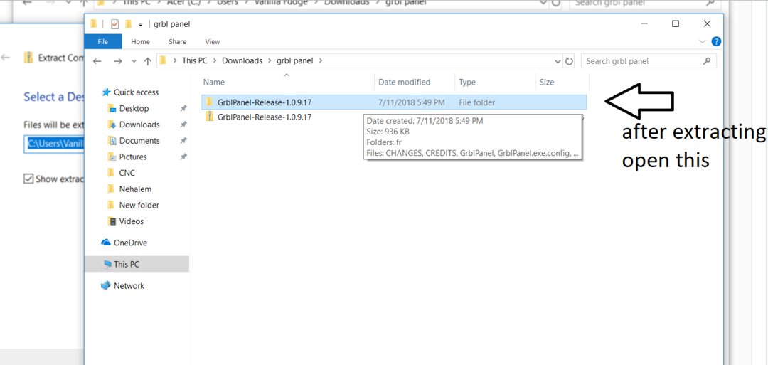

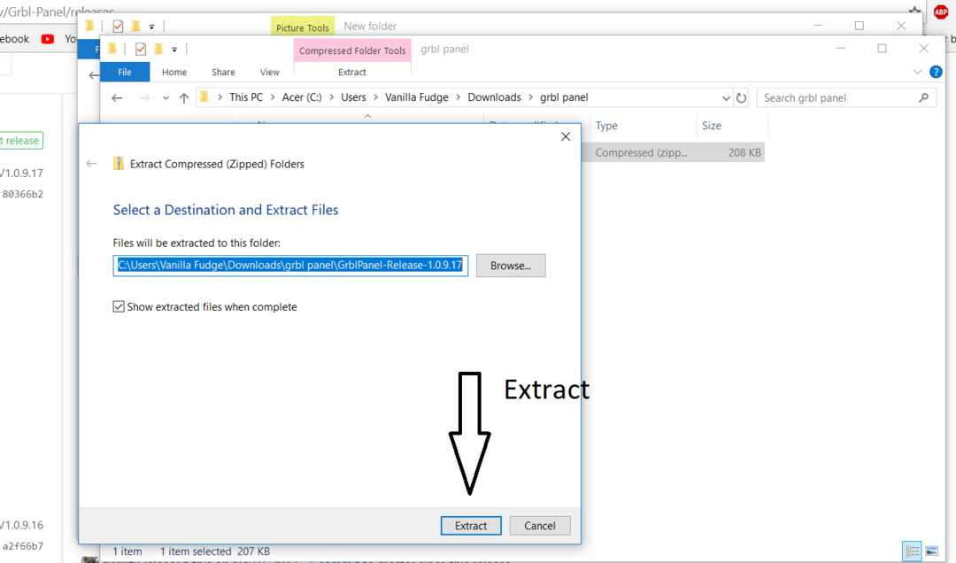

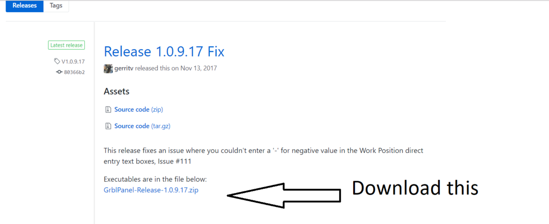

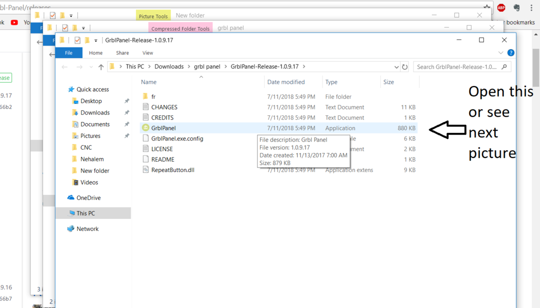

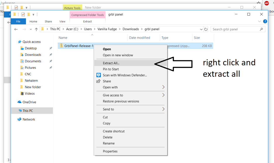

  9. Giarc
    2,979
    1,662

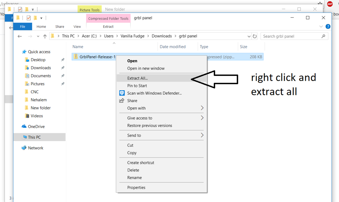

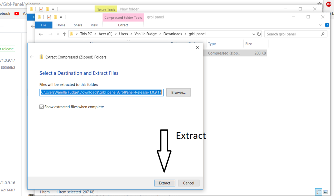

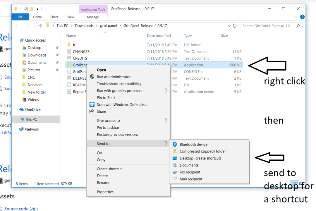

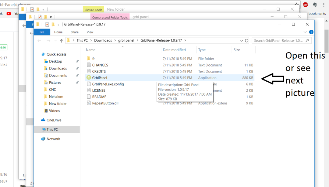

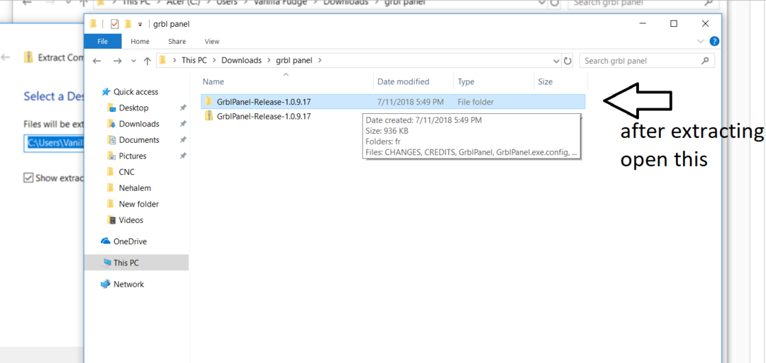

    Here you go, do this:
    Go to gerritv/Grbl-Panel Your ultimate goal is to get to, then open the GRBL Panel "Application" file. I sent a shortcut to my desktop (step 6). But it is not necessary.
    1:
    2:
    3:
    4:
    5:
    6:
    #9 Giarc, Jul 11, 2018

    alright! thank you SO MUCH! it is alive and moves. no funny sounds or acting like its binding or anything like that. now i can move on to the next step... learning everything else. lol again, thank you for your help and i am about 100.1% sure i will be asking more questions.
