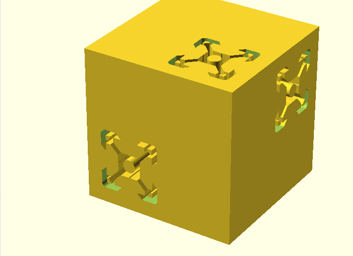

  4. Glenn West
    Dec 5, 2013
    23
    In building a corner component, or a frame, (In delta we call it a vertex), its handy to "subtract" a vslot
    from the body.
    Example code of something I was doing this morning.
    When you use this, you get more complexity that needed. It results in non printable part.[​IMG]

  5. Franco Ponticelli
    Dec 4, 2013
    65
    14
    Oh I see. I was planning to make a simplified version of it to speed up rendering time but to be honest I just didn't feel the need yet. If I recall correctly commenting out the part that subtract the holes on the corners and the one in the middle should be pretty trivial. Feel free to create a pull request if you find yourself adding interesting features to that file.
