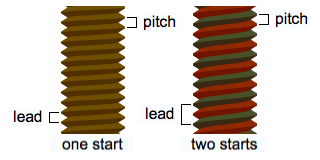

    Keith, can you help me understand where the number of starts on the screw would come into the equation?

    +Josh B Threaded rod always has only one start, therefore pitch and lead are the same. Acme threads can have multiple starts and lead (the distance traveled) = starts * pitch. In these calculations pitch is irrelevant, lead is what we are measuring.
