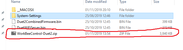

    Maybe a stupid question, but how on earth do I update the web interface on my Duet with my Ooznest Workbe?
    I've downloaded every file and done everytning that's stated in the manual, but still no luck.

    You didn't say, but I assume you are updating to version 7, and that you have followed the instructions and loaded the system settings for your machine to the Duet controller, and that you now can't see the new User Interface. If that is the case you have missed the step in the attached pic - the user interface update is a separate step. Using the Duet Web Control upload that zip file - you don't need to unzip it first.

    Worked like a charm! Wonderful!
