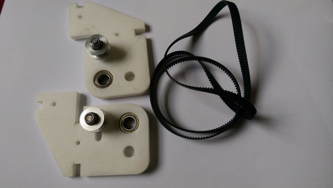

    There is an alternative. Look at your i3. Now imagine using only one of the motors, but also having a belt across the top with a pulley on each of the two screws. The powered screw turns the unpowered screw with the belt. Below is a picture of what that type of upgrade looks like on an Anet A6. Basically you need to design a couple of top brackets that have slots in them for idlers. Below is one of those kits for that Anet A8
    Let me know if you need further explanation. I've sold dozens of those Anet A6 kits and everyone is pleased with the results. For your flavor of i3 you may need to modify the design, but if you can see a way to do it, it's a LOT cheaper than throwing away an otherwise useful printer.

    2018-07-20 10.49.04.jpg Much appreciated. I've spent quite a while going through your site, & I saw your Anet upgrade kits & was really impressed by it. I started to design my own upgrade for my Geeetech Pro W a few weeks ago or so, & got all the belts & pulleys that I needed ( I had some bearings laying around, left over from a past project). If you look closely at version 0.3 of my design, you'll see that I've only got one slider to alter the belt tension, which meant that my belt was just too tight to get on. I got sidetracked before I could cook up version 0.4 with a slightly longer tensioning slider on both top plates. As I've still got my original threaded bars from before my lead screw upgrade, once I get the TrueUp upgrade properly working, I can try subbing them back in instead of the lead screws to address the micro-stepping issues. I've also got problems with bent X-axis bars & bent Y-axis bars, & the fact that there is over 1mm of difference in the distance between the lead screw & frame between the left & right hand sides. So much on this printer is just sooo badly manufactured....

    When I finally clocked that it has squareness & flatness built in, that's what completely sold it to me. I also worked out that it was much more difficult (ie flogging a dead horse) to fix my Geeetech than it was to design & build a completely new frame. I've already got an original E3D Titan & Lite6 setup as the stock extruder & hotend were worse than the rods.
