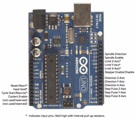

  8. Flash22
    Flash22 Well-Known
    Sep 1, 2015
    159
    42
    The Arduino and DQ524 drivers is all you need - you do not need any shields or a TinyG (Thay are just motor drivers)
    Use the 2 pictures above and wire them up install grbl on the uno and away you go
