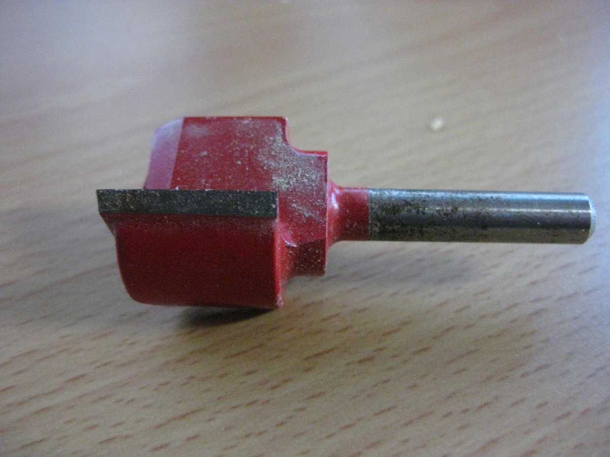

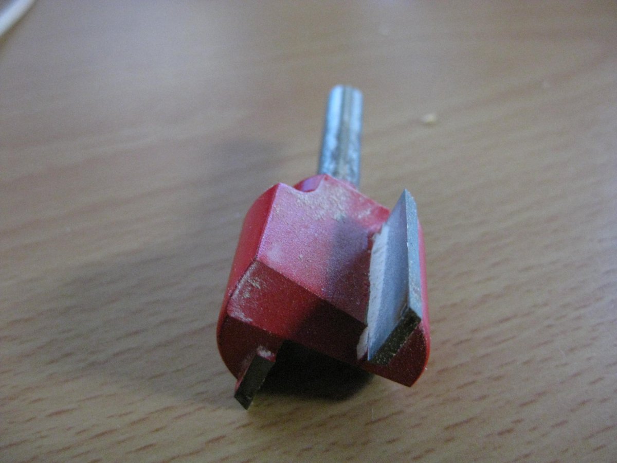

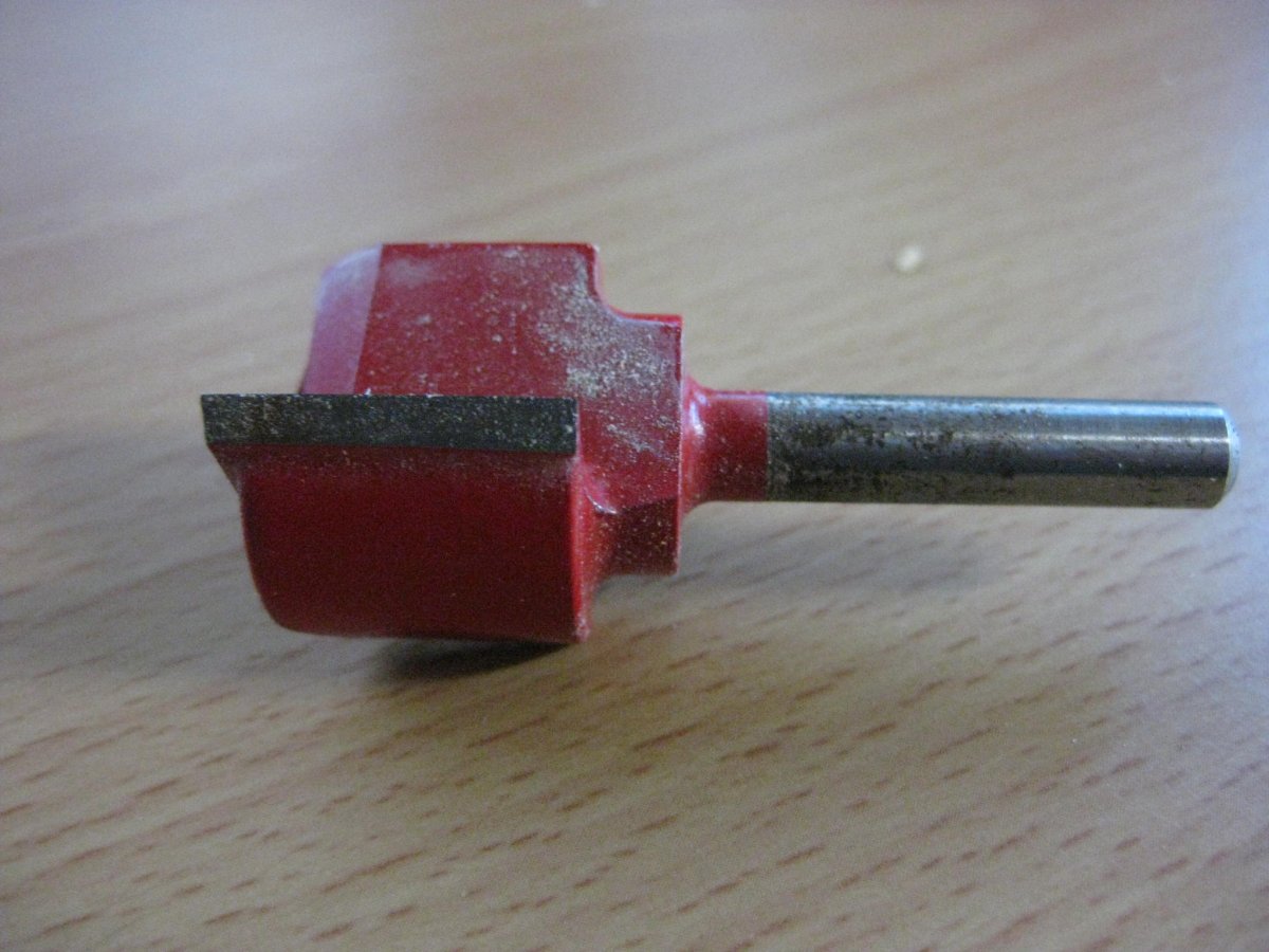

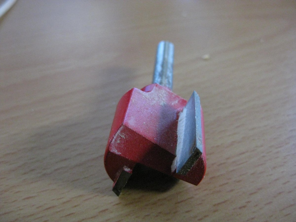

  14. Hytech2k
    Hytech2k Veteran
    May 6, 2014
    429
    331
    As for bits, you can always go down to the local Lowes or HD and pick up a bit like this: Shop Skil Carbide-Tipped Bit at Lowes.com or even the Bosch counterpart. In my experience they work just fine for surfacing a spoilboard, set the step over closer to 40% and they surface just fine. In fact I use a 1 inch Freud 1/4" shank version for my smaller machine I picked up at the local HD.

    Just a good idea to use a ramp in move with these bits, only difference really.
