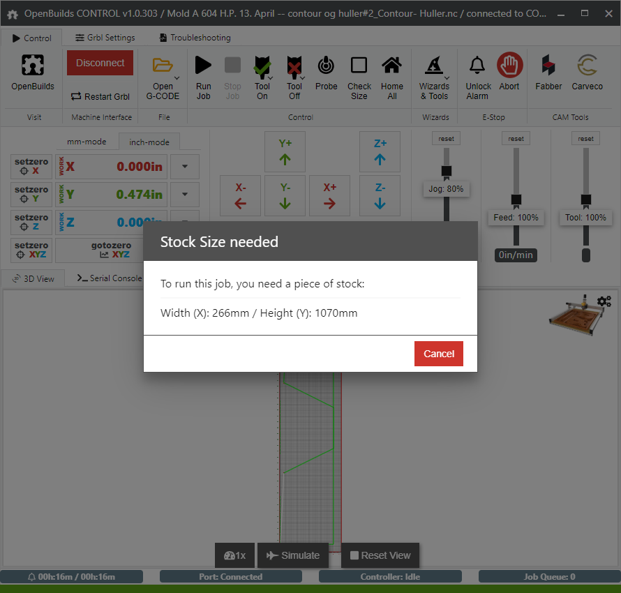

  11. JP Cassar
    JP Cassar New
    May 3, 2024
    Sharing my updates:
    - Round to 3 digits after comma
    - Added fractional measurement for inches
    - Split output into 2 lines
    Code:

    if (typeof object !== 'undefined') {
       var precision = 32
       var string = ""
       if (object.userData.inch) {
           string += "Width (X): " + round((object.userData.bbbox2.max.x - object.userData.bbbox2.min.x), 3) + "inch (" + Math.roundFraction(object.userData.bbbox2.max.x - object.userData.bbbox2.min.x, precision) + ") <br/> " + "Height (Y): " + round((object.userData.bbbox2.max.y - object.userData.bbbox2.min.y), 3) + "inch (" + Math.roundFraction(object.userData.bbbox2.max.y - object.userData.bbbox2.min.y, precision) + ")";
       } else {
           string += "Width (X): " + round((object.userData.bbbox2.max.x - object.userData.bbbox2.min.x), 3) + "mm" + " / " + "Height (Y): " + round((object.userData.bbbox2.max.y - object.userData.bbbox2.min.y), 3) + "mm";
       console.log(string)
       Metro.dialog.create({
           title: "Stock Size needed",
           clsDialog: "dark",
           content: `
              To run this job, you need a piece of stock:<hr>
              ` + string + `
           actions: [{
               caption: "Cancel",
               cls: "js-dialog-close alert",

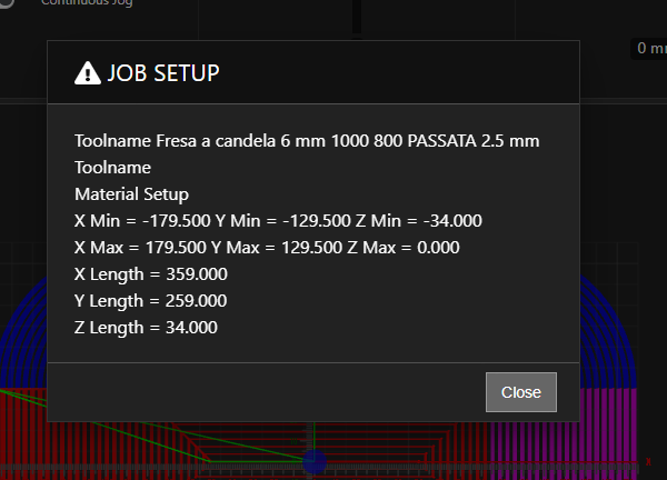

  15. kaoscreations
    Aug 9, 2022
    13
    uhao super!! but it's possible add also the information about toolpath that I've insert in my Gcode for postprocessor?

  18. kaoscreations
    Aug 9, 2022
    13
    Yes, thanks!
    I was wondering if in this screen the information on the size of the piece would come out, also including the depth of the Z, and the information on the cutter to use (if they exist in the original Gcode).
    For example
    To do this job you need a piece of this size
    x ----
    y----
    z---
    and these tools
    (tool size),(tool name)
    Are you saying it can be done?
  19. JP Cassar
    JP Cassar New
    May 3, 2024
    Yes for Z. Locate this line:
    Code:
    and replace by:
    Code:
           string += "Width (X): " + round((object.userData.bbbox2.max.x - object.userData.bbbox2.min.x), 3) + "inch (" + Math.roundFraction(object.userData.bbbox2.max.x - object.userData.bbbox2.min.x, precision) + ") <br/> " + "Height (Y): " + round((object.userData.bbbox2.max.y - object.userData.bbbox2.min.y), 3) + "inch (" + Math.roundFraction(object.userData.bbbox2.max.y - object.userData.bbbox2.min.y, precision) + ")<br/>" + "Depth (Z): " + round((object.userData.bbbox2.max.z - object.userData.bbbox2.min.z), 3) + "inch (" + Math.roundFraction(object.userData.bbbox2.max.z - object.userData.bbbox2.min.z, precision) + ")";
       } else {
           string += "Width (X): " + round((object.userData.bbbox2.max.x - object.userData.bbbox2.min.x), 2) + "mm" + "<br/>" + "Height (Y): " + round((object.userData.bbbox2.max.y - object.userData.bbbox2.min.y), 2) + "mm<br/>" + "Depth (Z): " + round((object.userData.bbbox2.max.z - object.userData.bbbox2.min.z), 2) + "mm";

  26. kaoscreations
    Aug 9, 2022
    13
    This is Fantastic thanks!! I've tested this, if it were possible you could insert the fact that the close button closes (now I have to make several clicks) and that the alarm goes off after 3 seconds (or if I can set it, can you tell me how to do it? I tried to change the timeout but I'm doing something wrong ). It's seems like that are opened 15 screen of the same alert :(
    Furthermore, if possible, could it be made to work once the file has been loaded or even with a push button? so if I forget the parameters I can recall them :)
    Thank you very much and congratulations, super work!!
    #206 kaoscreations, May 27, 2024
  27. sharmstr
    2,059
    1,448
    My guess is that you've clicked the macro button several times and its loaded the function several times. Its meant to be run once at startup, so edit the macro and select "Run Macro on startup". Save and restart Control.
    If you need to recall the info, click on the GCODE Editor tab. Its all the start of the file
  28. kaoscreations
    Aug 9, 2022
    13
    hi!! this is perfect, works very well, thanks!!!!
