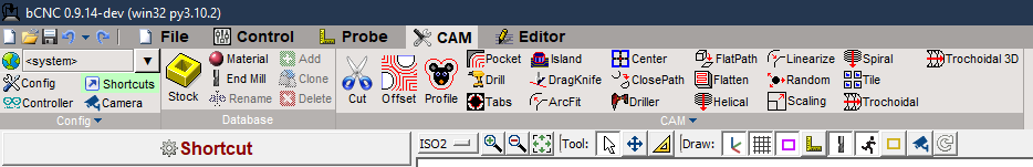

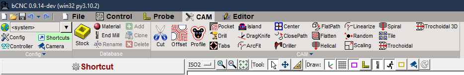

You can do that with bCNC GitHub - vlachoudis/bCNC: GRBL CNC command sender, autoleveler and g-code editor I mapped some function keys to the save point functions, cant recall exactly how to do that, once set it just works (for some years now). I use it with the camera function for digitizing drawings (-: Looks like the relevant buttons are not documented (yet, I will try to edit the wiki) I have F7 as RRAPID and F8 as RFEED in the shortcuts setup. These keys then save the current position as a 'rapid to here' or 'feed to here' respectively.
note that bCNC also has a bunch of buttons for adding drilling, pocketing etc, so you can digitize an outline and then add a pocket or flatten operation to that outline.

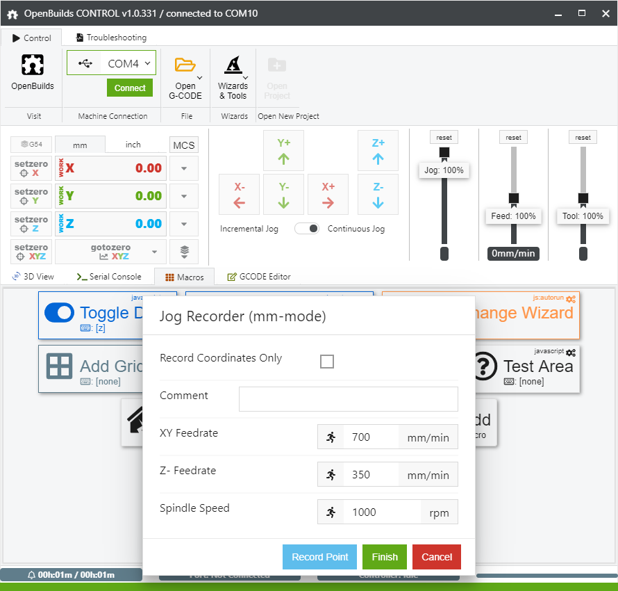

It doesnt exist in Control, but it can be done with a javascript macro and the gcode editor. If I have time today, I'll take a look at it.
Simple proof of concept using the capture point method. It obviously would need to be more robust, but a working starting point for sure. Need to think about this, but might make the simple version free on my website and the more advanced tracing available at a small cost.
Oh man that is perfect and all I want. Is it something you want to go ahead with or is it something I can be instructed on how to set up in the openbuilds controller software? I open for make a payment for that Best Regards Stig.
I think I got it now. I need to test on the machine tomorrow. There were a lot of little things that had to be programmed in which wouldnt have to be if I were the only one who would be using it. The big ones were support for mm or inches and dont record the coordinates if the machine it still moving. Anyhow, I should have something posted tomorrow.
