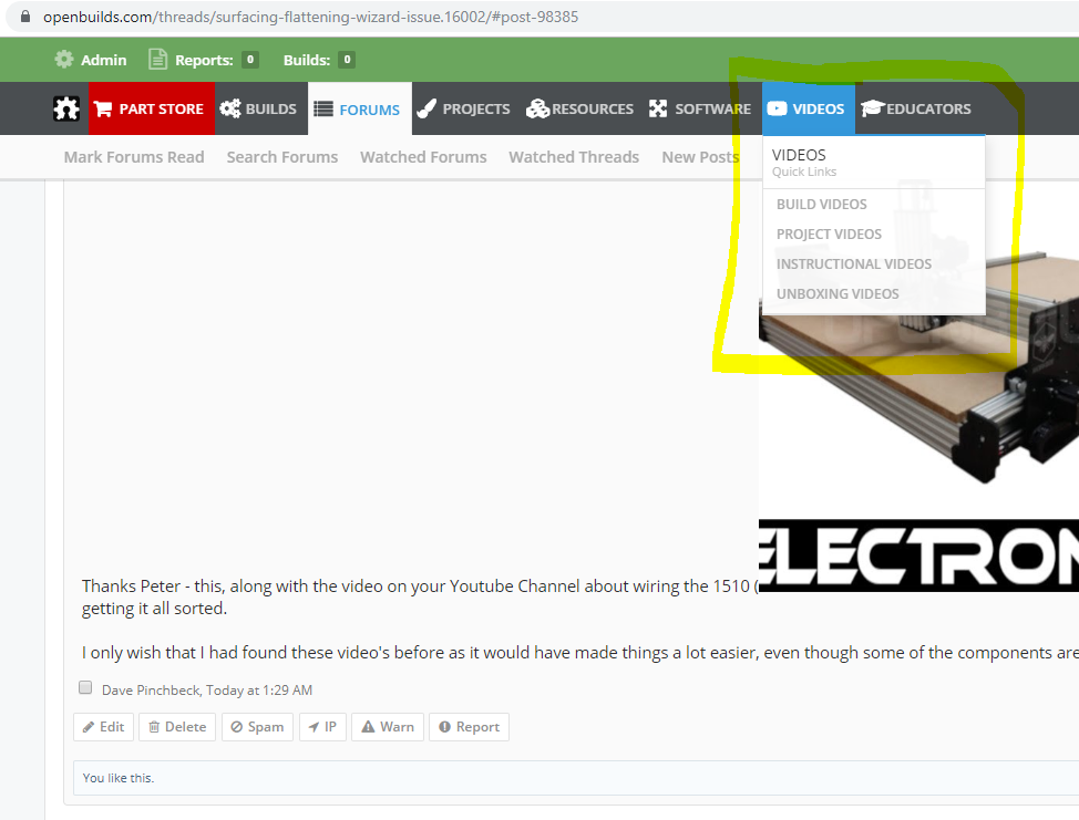

    13,897
    4,086
    Just look upwards :)
    Also, checkout start [OpenBuilds Documentation] as another great resource
    Dave Pinchbeck likes this.

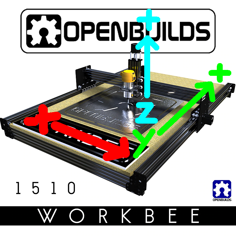

  8. David the swarfer
    3,268
    1,832
    Z home must be at the top of Z travel, the positive end.
    axis directions are
    then you use the 'setzero' buttons to set the 'work' zero position, all the Gcode runs relative to the work zero, but some Gcode also uses the machine home for some safety moves so having the machine home correct is critical.
  9. Peter Van Der Walt
    13,897
    4,086
    Surfacing wizard only uses work coordinates. So you likely forgot to SETZERO at the top of the surface you want to skim.
    Homing does NOT set Work coordinates. Homing only sets Machine coordinates (G53). All other coordinates are stores as offsets from Machine coordinates to allow reestablishing them after power/reset by rehoming, but you still have to to set those offsets with the Setzero buttons
