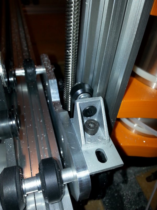

    I reduced the Z axis torsion by putting mini v wheels behind the Z 2060. Here's a picture:
    #4 dddman, May 18, 2016

    Nice idea Dany.
    I added another wheel to the Z rail in that area for 4 wheels per side instead of 3. I really don't see any flex there.
