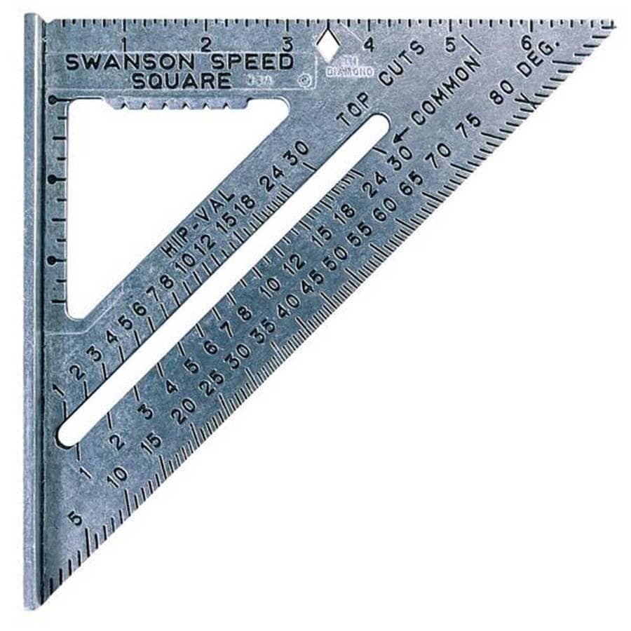

    (2) Use a carpenter's square or speed square. The problem here is that the gantry rail and the side rails are not on the same plane. So it is somewhat hopeless to try to eyeball it.

    Are you trying to square the Y gantry plates to the X axis? If so, the best way is to make sure the ends are cut square to begin with. Then, what I did was hold a speed square on while tightening up the screws to make sure I was not pulling it out of square while tightening the screws. I never cranked any tight until all were snugged up fairly well. This method worked for me. But, I made sure the cuts were square first.
