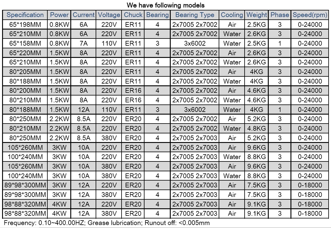

    While running around trying to get more info, I ran across this nifty chart.
    I know there is quite a bit of confusion (at least for me) on all of the different variants. The main variables are cooling method, voltage, and power. Then you have quad vs triple bearing and collet sizes.
    for the quad
    I'll be building a Sphinx and was looking at a water cooled 1.5kW 220V. I was probably going to run it through a 110>220V transformer if I couldn't get 220V. I figured the 1.5kW would have much beeter low end torque since I plan on mainly cutting aluminum. I haven't had much issues with a Bosch Colt 1hp, but I have to run at a high rpm.
    My main question was whether a 110V VFD could run a "regular" 220V spindle.
    I don't know how accurate the chart below is. I found it in the thread below.
    X carve upgrade to .8KW water cooled spindle W closed loop cooling

    A 120 VAC, 20 A circuit is only rated to deliver 1920 watts. A 240 VAC, 20A circuit can deliver 3840 watts. You would have to put in a 30A 120 VAC (2880 watts) circuit to serve a 2.2KW spindle and a 3KVA step up transformer. I strongly recommend a 240 VAC circuit.

    I haven't really looked back at this due to financial reasons. I've been using my little Bosche without much of an issue. My biggest problem is currently voltage. I want an ER16 1.5kW water cooled spindle. I can find air cooled in 110V.
