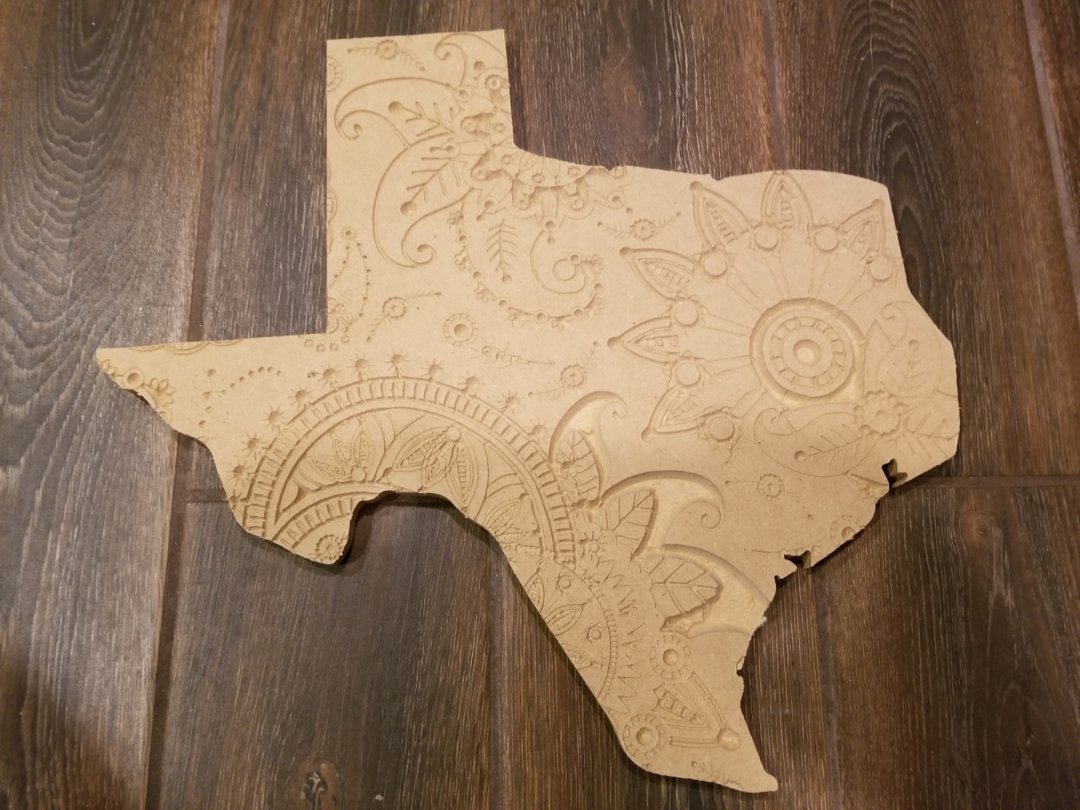

  26. Troy Proffitt
    Troy Proffitt Journeyman
    Oct 11, 2016
    126
    101
    Final result
    MaryD and CNCMD like this.

    Sweet! Are you seeing any notable performance or rigidity difference from the upgrade?
  28. Troy Proffitt
    Oct 11, 2016
    126
    101
    Yes, i was able to increase my rates, and i notice a lot more detail in the final cut. Also when surfacing my bed, i noticed the original setup bowed in the middle so there was a 2mm dip in the middle of the bed that was fixed
