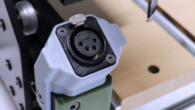

    Are custom stl file available?
    xlr mount is awesome!

    Thanks. Im looking for the 3d printed part for the xyz probe

    If you are talking about this,
    I checked his Thingiverse account and was unable to find it there. It is strange it was not added in the file sections here. Kyo is a really thorough maker and has put files up of just about everything. Hopefully, he comes back soon.
    That being said, it looks like a fairly straight forward design, so it could be replicated easily enough.
    Kyo and David the swarfer like this.

    it is exactly what i was looking for.
    Clever idea!
    Id like to add it my build
    thanks for your research!

    @Hykr3n
    I apologize for the slow response. After checking my Fusion 360 projects folder, I do still have that file. Please find attached the STL.
