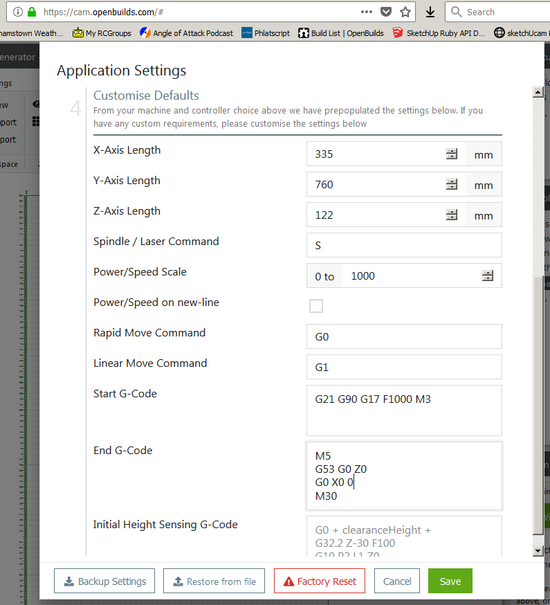

    @Mark Carew : on the cam setup it shows the 'end gcode' as below
    but that is incorrect
    it should be
    G0 X0 Y0 ; the Y is missing from your code
    AND!!!!
    I cannot type a Y there to fix it. many other letters can be typed, but not Y

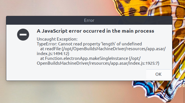

    @Peter Van Der Walt , still not working for me, but the problem is probably on my end:
    been having some Java issues since upgrading to 18.04. I got the linux driver at github, installed the deb and the browser based CAM finds the driver. The App itself doesn't open. I get the above error instead. I guess I'll fiddle with it all later! Thanks!
  12. Peter Van Der Walt
    14,571
    4,230
    :) Always a chance its our side :) - especially the Linux side (not so many users - so gets a bit less testing) - so don't rule that out yet :)
    I picked up you knew a little though when I saw you checking the placeholder/href )
    Quick question: Is this the DEB or the AppImage one?
    (I'll download 18.04 tonight - been putting off updating) and see if I can replicate - the AppImage shouldnt be running in /opt - and maybe just maybe the .deb installer is doing something odd)
    If you are on the .deb, try the AppImage too - it's kinda cool AppImage
  13. joe williams
    joe williams Well-Known
    Nov 9, 2015
    100
    59
    so now everything is magically working, download buttons and the app. Downloaded the deb a second time, installed it and it works (there was some kind of error screen, but it continued on to load and run) Jogging my test setup now!
  14. Peter Van Der Walt
    14,571
    4,230
    :) Sweet! I fixed the download button bug (stupid mistake, had a little code in there (windows only) from before we added the mac/linux versions hehe) so I'll say that less likely magic (;
    But the other one, I didnt do a fix.
    However the error was because it was started with a parameter, which wasnt a file.
    (You can run './openbuildsmachinedriver file.gcode' and it'll open the file. The error looked like it was getting a parameter, but said parameter wasnt a file. Maybe ubuntu was adding something onto the end of the command for some odd reason. Still, it needs some extra coding to handle that without throwing an error :) - the 1.8gb Ubunntu 18.04 ISO is in my download queue - will see if I can replicate and then fix
