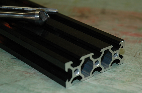

    Cut V-Slot extrusion to required lengths. Optional: mill / sand and cut ends as square as possible to ensure ease of alignment later on.

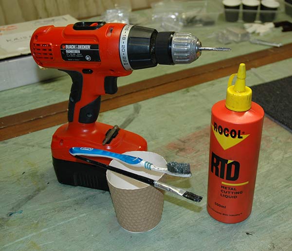

    Tap V-Slot for mounting.
    We recommend tapping the following:
    • Z-Axis - all holes
    • Gantry lengths - all holes
    • Long X-Axis bottom half x 8, top half optional x 8
    Tapping the front lower support for covers / drag chain / support / feet is optional. The front upper support and table support is not required to be tapped.
    A small chamfer helps guide a tap when using a powered drill.

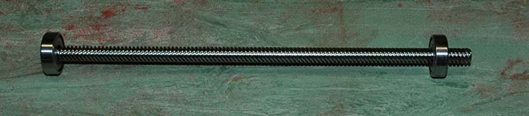

    Cut threaded rod to required length. Smooth ends.
    Check that bearings fit over the ends (a very light sand with some fine emery paper will help a sticky bearing).

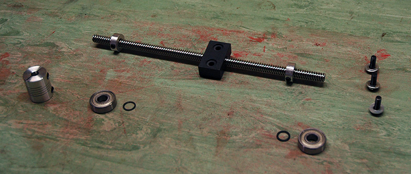

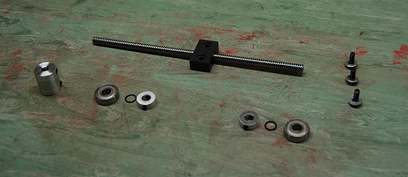

    Assembly of Z axis

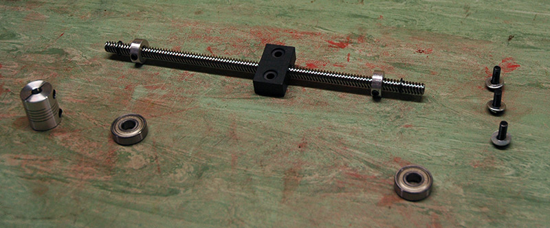

    Thread ACME nut block onto ACME lead screw, with the hex nut closest to V-Slot.
    Place a locking collar onto each end.
    followed by 8mm spacers on each end,
    and lastly a bearing on each end.

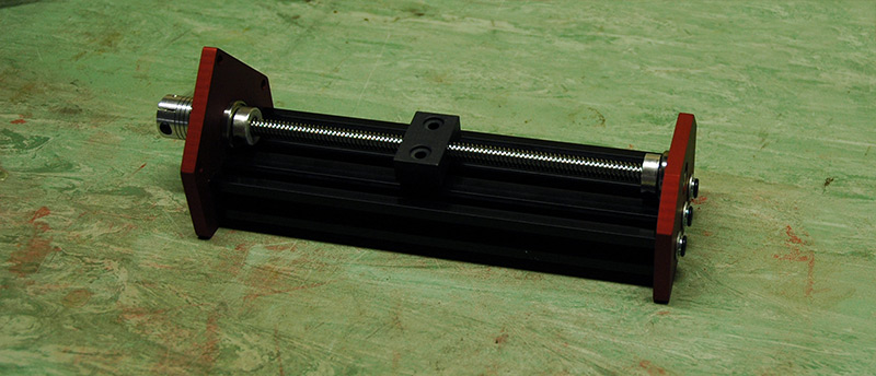

    Once set up, install upper Z plate using 3 M5 x 15mm screws, each with a spring washer and standard washer. Lightly assemble finger tight.
    Install required tee-nuts to front of Z-Axis V-Slot plate. You can use masking tape to hold these in place so they don’t fall out when you are attaching the Z axis to the gantry plates.
    (yes we forgot this step and had to slip off the bottom plate and add them later on …. )
    Install screw assembly onto V-Slot and top cap and then the lower plate 3 x 15mm M5 screws, each again with a spring washer and standard washer.
    Adjust end caps as parallel as possible to the V-Slot.
    Snug down all bolts on end caps. Check alignment.
    Once snugged down, adjust threaded rod so that 10-12mm extends beyond the top plate. Lock off the 1 x locking collar on the top plate using the grub screw.
    Pushing the lead screw towards the top plate, simultaneously pull on the bottom locking collar to apply tension to the lead screw before finally locking off the grub screws on the bottom collar.
    When done correctly, there should be no lateral movement or play.

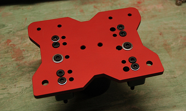

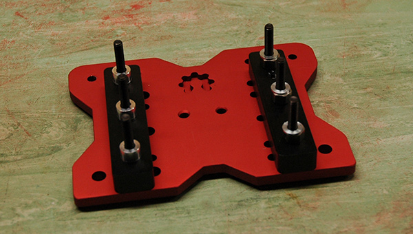

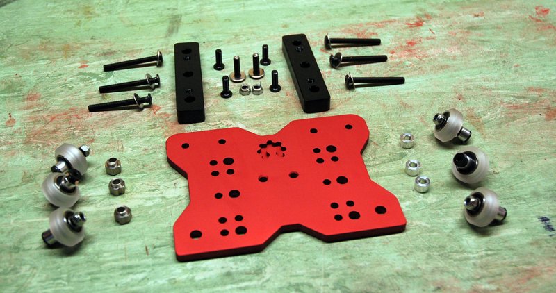

    Assembly of Front Carriage Plate
    Install spacer blocks to the front carriage plate, using 4 of M5 x 15mm screws. It is good practice at this point to square off.
    Install the M5 x 45mm screws (x6) with washers, standard where possible although you may need to use small washers where there could be clearance issues.
    Flip over. Check the orientation of the plate to ensure the eccentric holes are on the bottom of the front carriage plate.
    Place 1 x 9mm spacer on each of the M5 x 45mm screws on the right hand side of the front carriage plate. On each screw place 1 x wheel (we are using the Solid V Xtreme Wheel kit) and nyloc nut.
    On the left hand side of the front carriage plate, place 1 x 6mm eccentric spacer, along with a 3mm spacer on each of the M5 x 45mm screws.
    Note: You can do these around the other way (the eccentrics on the right hand side and the 9mm spacers on the left), this is purely our preference.

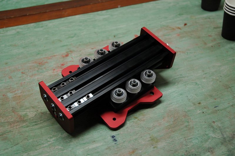

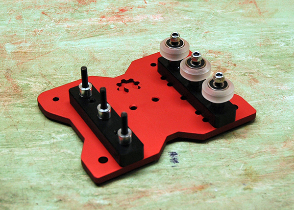

    Install the Z-Axis. Drop wheels onto the right hand side, along with nyloc.
    Here comes the tricky part! Whilst holding the front carriage plate up, insert 2 of the M5 x 20mm screws into the ACME nut block.
    Lightly snug the 6 wheels. Once all snug, tighten the right hand side (with the 9mm spacers).
    On the left hand side, adjust the eccentrics until the wheels have light tension.
    Tighten screws into the ACME nut block.
    Movement should be smooth.
    You can choose to use M5 x 65mm hardware for this. We are using longer hardware cut down to ensure the bearing runs upon a smooth shaft. To note, the M5 x 65mm hardware has issues with the clearance of the front gantry plate as it’s a close fit.
    PHOTO OF CLEARANCE ISSUE to come
    Place a standard M5 washer on each of the M5 bolts.
    Insert one bolt each into the four corners of the front carriage plate. Please note the use of four small cups to allow easy assembly.
    Apply two eccentrics to the lower two bolts and on top of that, a 3mm spacer. On the top bolts, apply one 9mm spacer each. The large spacer size (9mm) was used to give more clearance because of the use of washers on the front carriage plate.
    Add one solid V wheel on each post.
    Add 1 x 9mm spacer on each post
    followed by a second solid V wheel on each post
    one precision shim (5mm x 10mm x 1mm)
    On the bottom two posts, add 6mm eccentric spacers, on the top two posts add a 6mm spacers.
    Apply rear carriage plate.
    Apply a standard washer
    and spring washer to each bolt (The spring washer could be omitted if you use nyloc nuts)
    and a standard/nyloc nut
    Tighten all nuts to half the travel of the spring washer (this is part of the reason why we use spring washers as it allows up to achieve even tension while adjusting parts of the machine).
    Align all eccentrics to their largest clearance, notch facing downward. Using a square, snug up all four bolts, doing opposite diagonals.
    This is a good opportunity to set your eccentrics. Get it running well on the gantry beans but we recommend the final tightening once the machine is assembled.

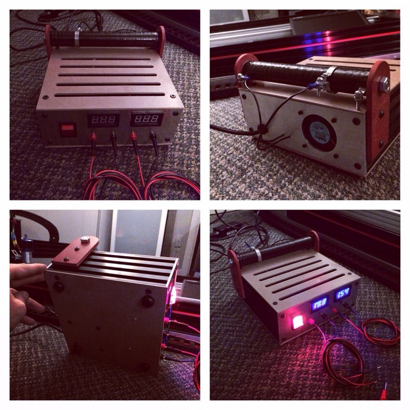

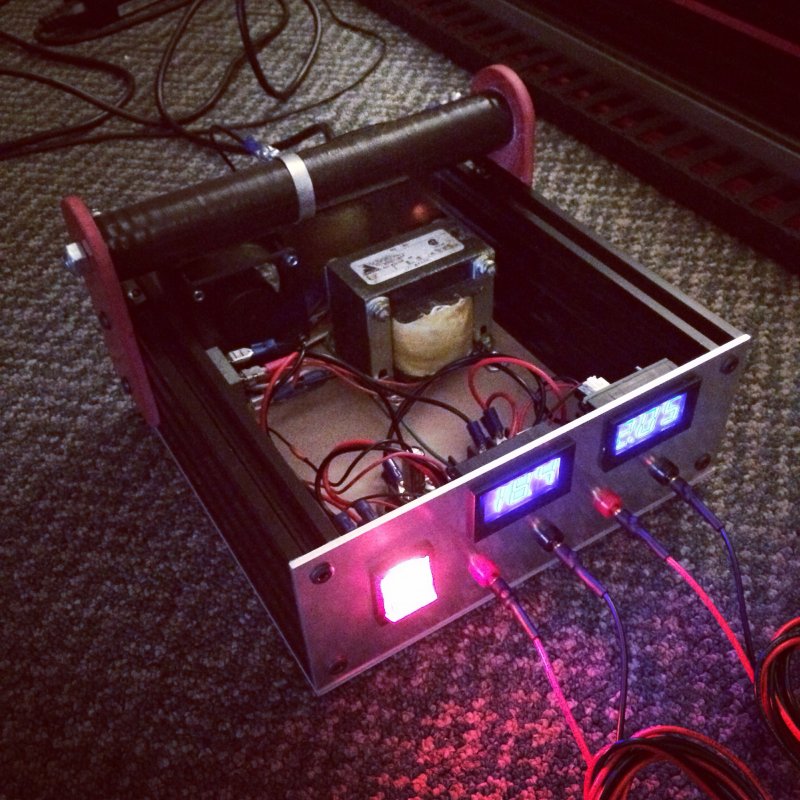

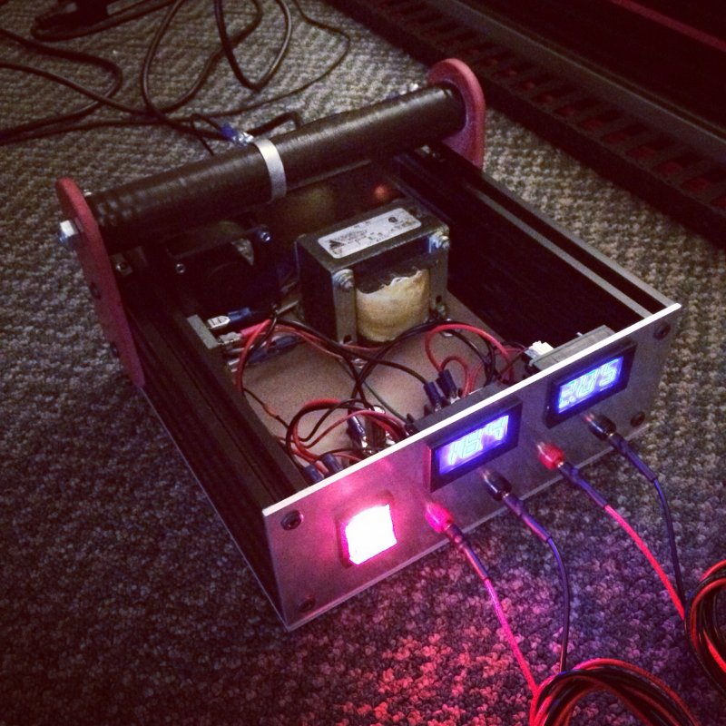

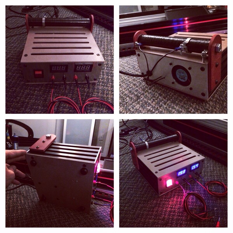

    Well I ran into another obstacle, the power supply.
    Took care of it by sifting through my junk bins and utilizing some off cuts of 20x80 :)
    I added two outputs so that I can anodize more then one item at a time or have two contact points ;)
    Kyo, GrayUK, Jestah and 2 others like this.

    I did some searching and came across this video on YouTube.
    I don't want to sound like an *** but the commentary is very,,,,, hmmmm informative but reminded me of a green muppet ;)
    I had everything on hand, added a 1000uf 25v elec cap and cooling fan.
    Then housed it all in an enclosure designed with sketchucam
