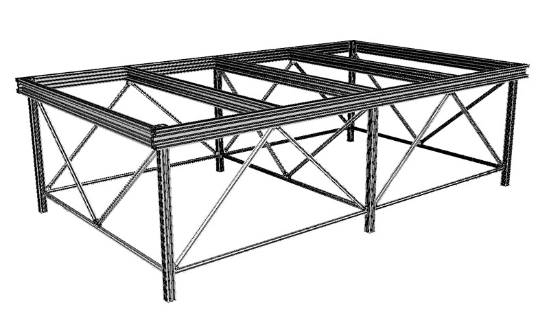

    I would like to make a slab flattening table with metal legs, similar to the picture of the CNC machine I have posted. I would want the Y axis to be 2500mm long, and the X axis to be 1500 mm long. I think the C-Beam linear rail will be good for the main four sides.
    In the middle, I think 20x80mm V-Slot Linear Rails running between the two long rails (in the X direction) would be the best support to lay slabs on. I would need 3 20x80mm v-rails to provide support roughly every 2 feet.
    I am open to suggestions on the legs, but currently am thinking 40x40mm simply because they are square.
    For the movable X-Axis, I would like two more C-Beams placed in parallel. My router would go between the two rails, and I could hopefully plunge the router low enough (Z-Directions) to reach the slab without shimming it up.
    I am really needing help with all the small accessories which would attach rails the rails and legs together. I obviously need a sturdy design that is flat and rigid. I have looking around this forum for anything close, and only found one thread about slab flattening. I would like my table to be build purely from OpenBuilds parts... No wood. Too bad I'm a complete idiot when it comes to google sketch up. Can anyone design what I need?

    @Tyler M,
    Sketchup file attached showing connections. It's not fully detailed but there is enough there to give you the idea. (T-nuts are not shown but should be considered implied.) Side rails were increased to 2700mm to account for the carriage width and still allow for the full 8' desired working length. No accommodation for automation included as none was requested.
    It should be noted that none of this has been tested. Should be workable but no guarantees. You may need to add additional connectors. The 90 degree Makerlink connectors were selected entirely on economy. They're less than half the cost of a similar connection with the cast 90s.

    Nothing in the OpenBuilds system will span anywhere near that far with any level of rigidity. I would suggest a single rail T-square system instead for ripping and cross-cuts. A second lowered rail on the opposite side of the table will accommodate the flattening sled without interfering with being able to lay 4'x8' sheets on the table for ripping.
