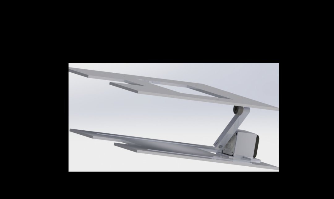

  6. jackantubis
    Jan 10, 2017
    Hi, really interesting design ;-) bravo! :) can you share how work your tilt, don't really see it on the pictures, thanks.

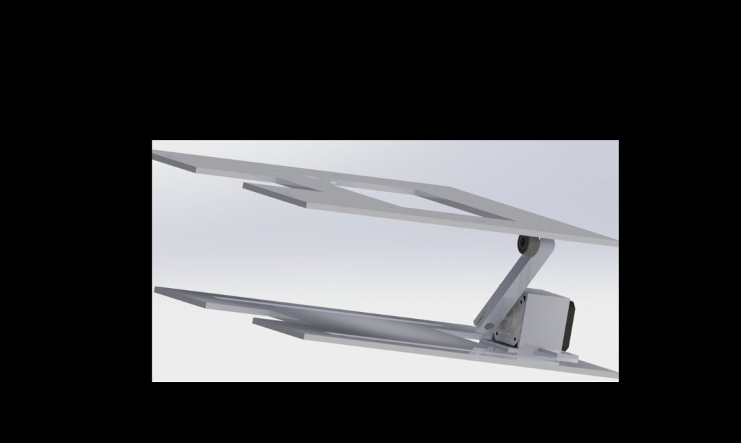

  7. mytechno3d
    mytechno3d Veteran
    Dec 15, 2013
    108
    308
    Picture of the Tilt system :
    I use Gcode to make the tilt movement : G1 X200 F100 ( example )
    jackantubis likes this.

  10. Techspeakr
    Apr 13, 2015
    It would be great to see how the cam pulls the vat/lcd away from the build plate. It isn’t obvious to me how the vat is mounted to the top plate and how it is free to pivot. - Doug
  11. Beëlzeblub
    Oct 17, 2016
    44
    Dunno if your still on the forum but i have some questions. :)
    Why a Tilt system? and is't 395 a bit low for the UV? or do you have good results? Speeds/ress
  12. evilc66
    evilc66 Journeyman
    Jan 9, 2015
    392
    153
    395nm is about as low of a wavelength as you will be able to pass through the LCD screen without it being filtered out heavily. Most UV resins will cure just fine at 395nm, just slower.
