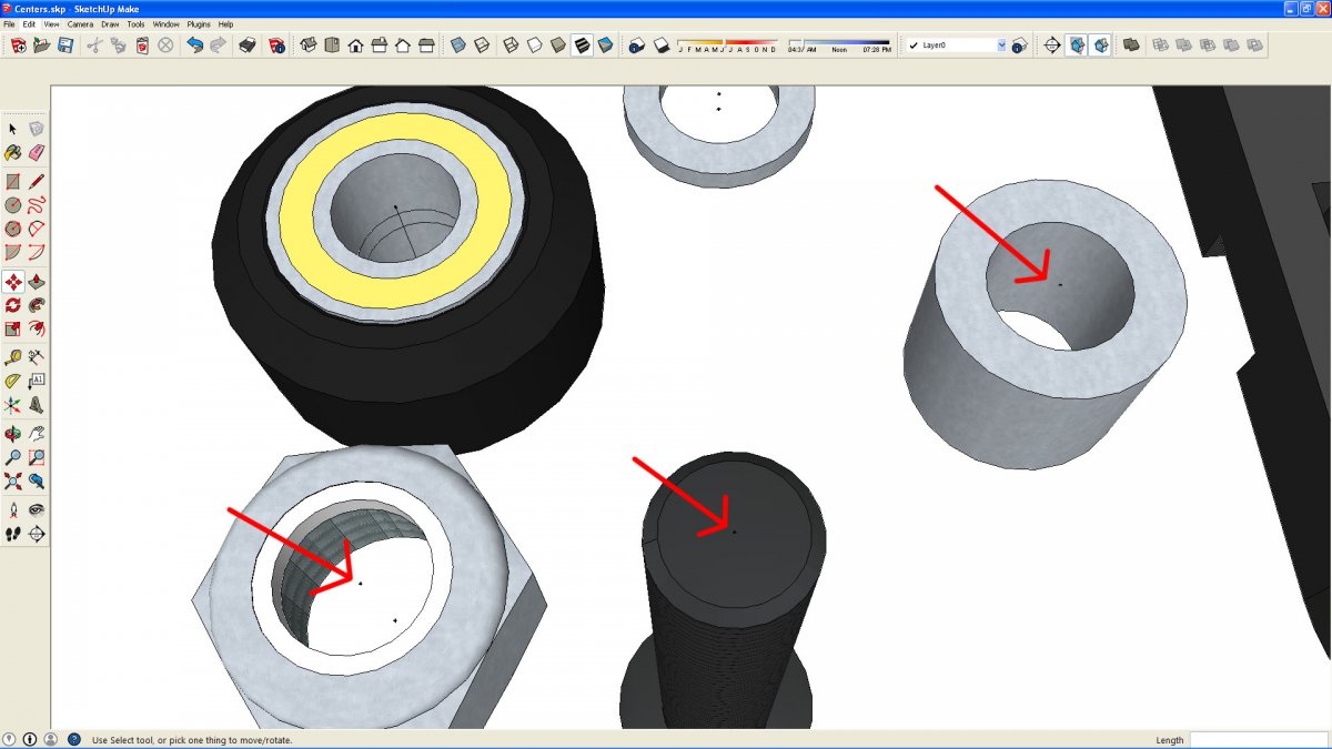

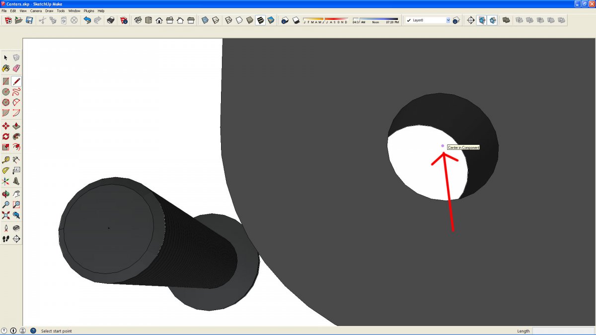

    This is what Kyo is referring to. The black dots are center marks.

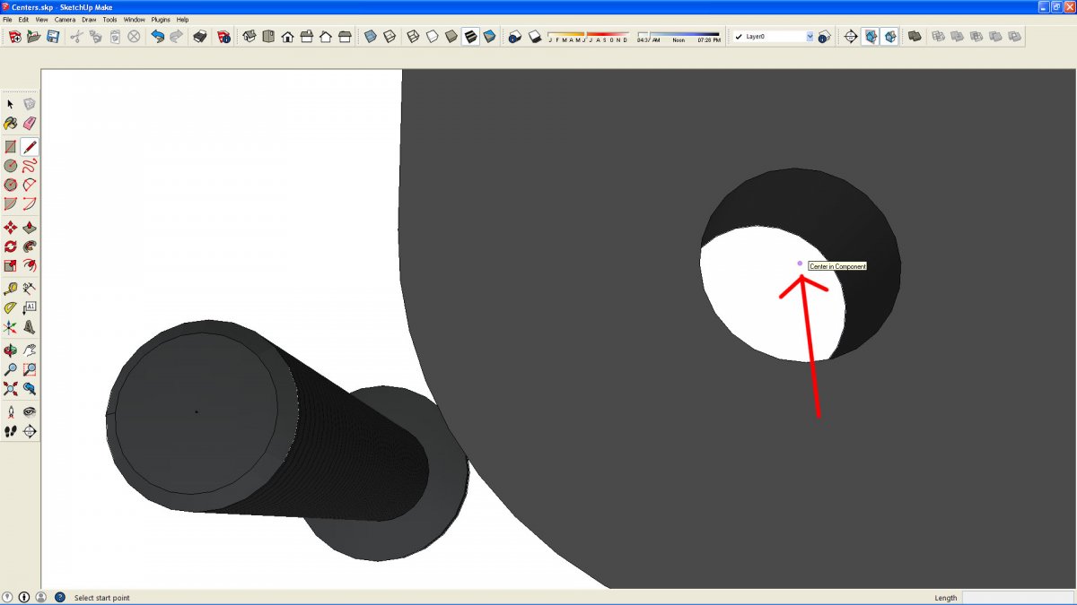

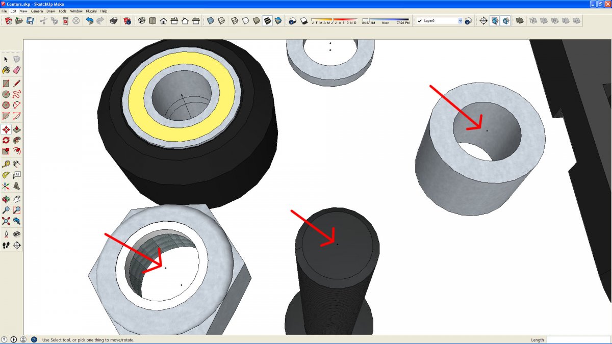

    The purple dots shown are snap to points and show up when you hover over the area you are trying to snap to.

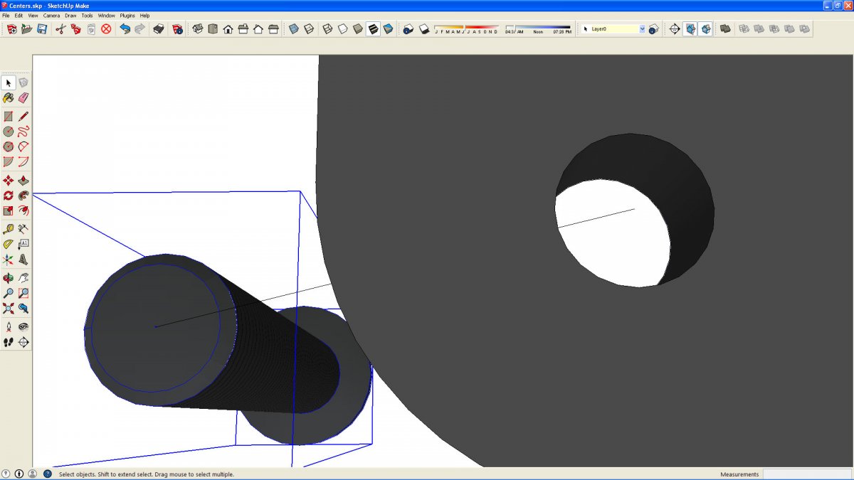

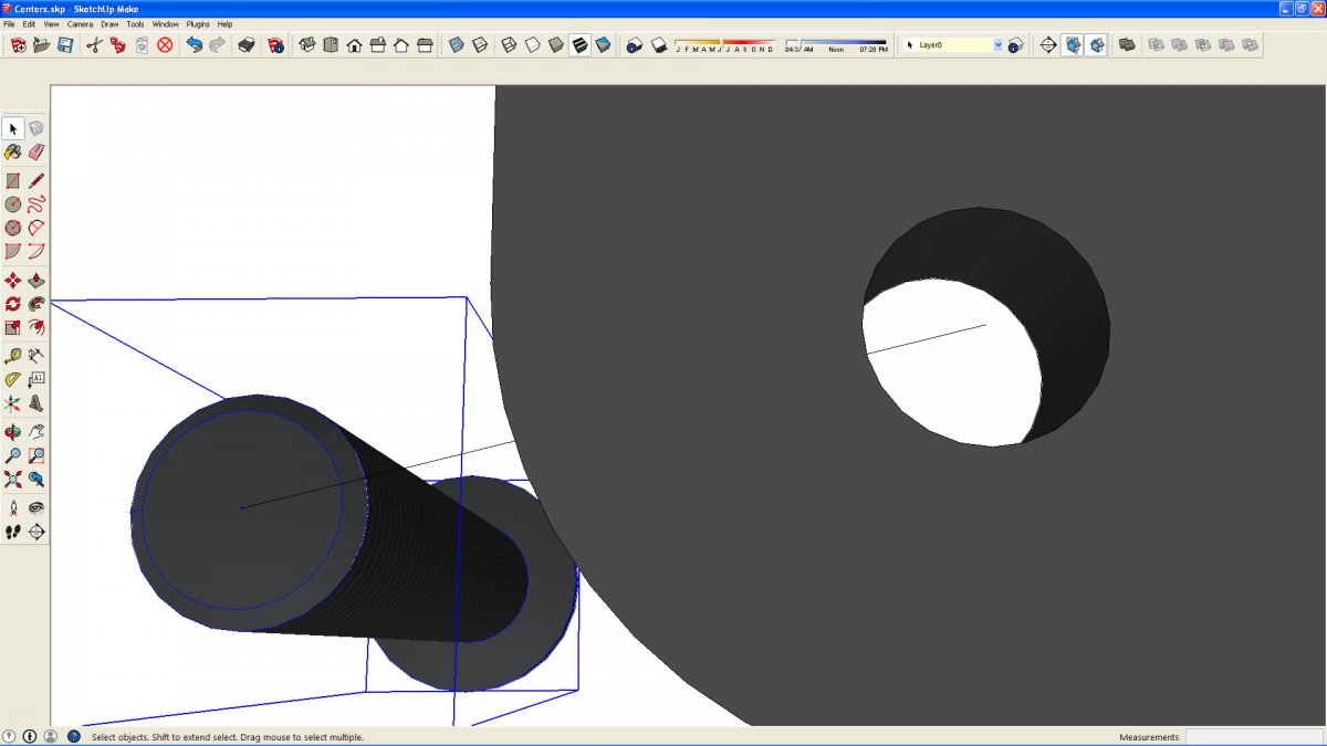

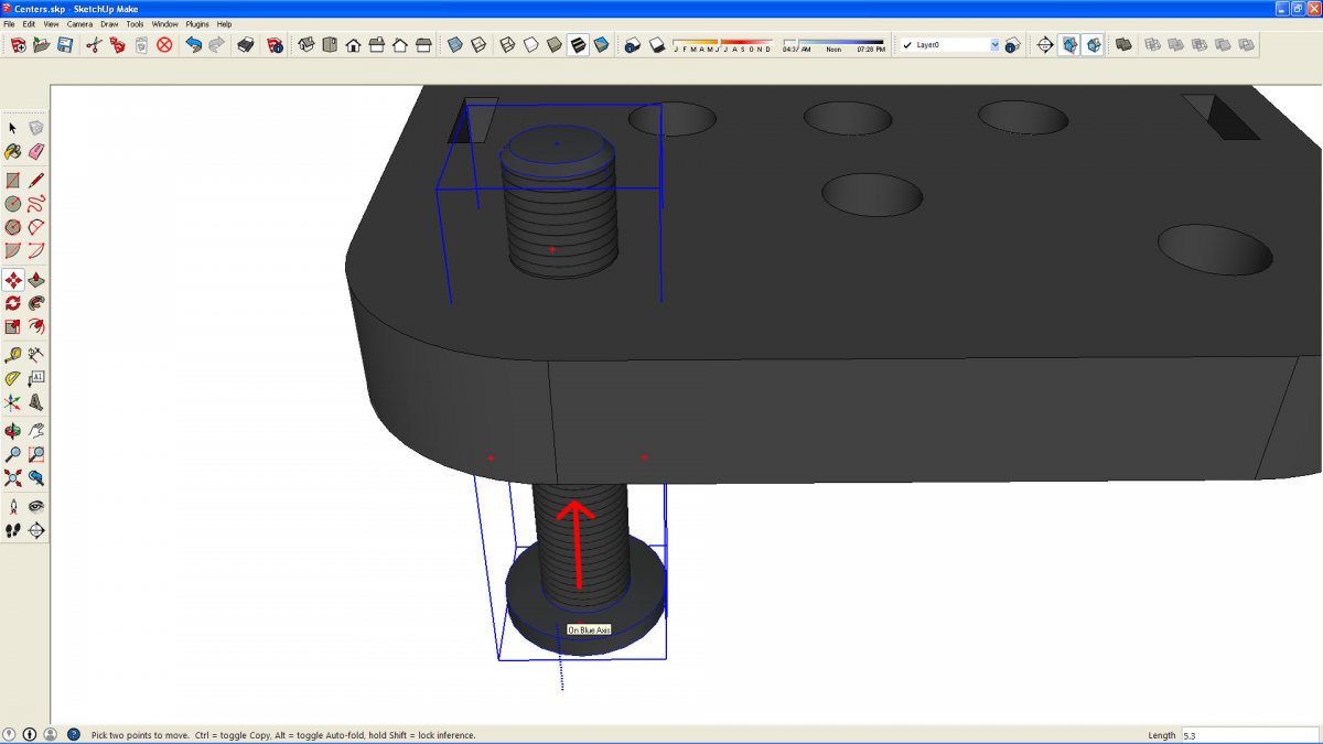

    The next step is optional but you'll find moves of this type easier when you draw a line between the two points.

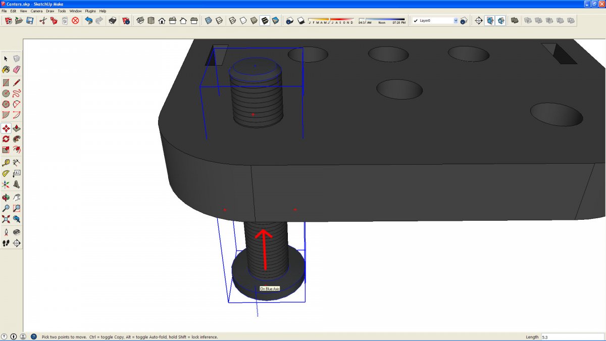

    Once you have the screw centered in the hole, simply move it up to where it needs to be. I generally grip the inside face of the screw head and slide it up to the mating face.

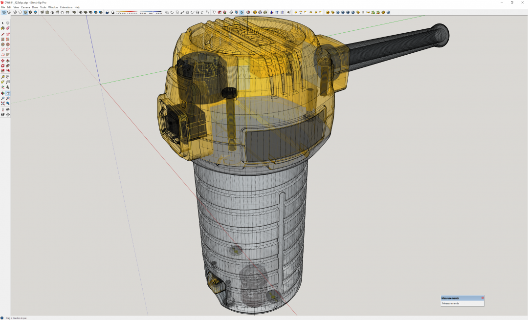

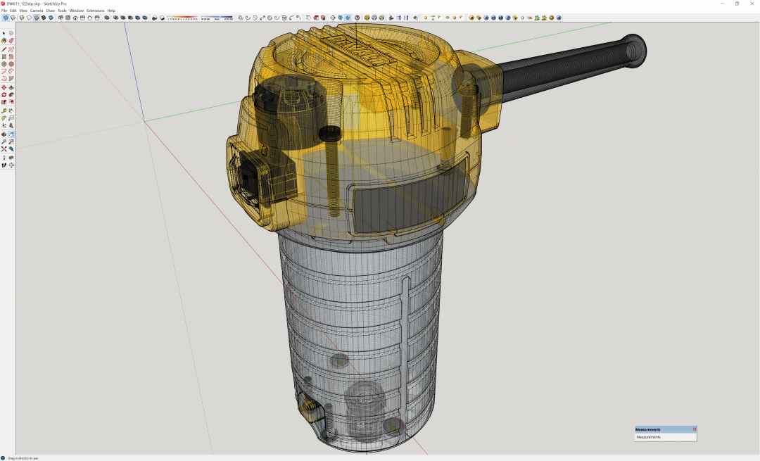

    Now, if you want to draw something a bit more precise, use circles that are made out of 96 segments and not 24. Also draw all at a 100x scale (100:1) as you will find that Sketchup hates to use anything smaller than 1.
    Note that SketchUp is vertex/polygon based and not polylines (splines) so drawings might look a bit square. Still it's a great program if you take the time to draw. I've been doing complex meshes like the DeWalt 611 router in 3 weeks and a few days, 8 hours a day (just the shell, +/- 0.3mm):
    And it's my fault that not all object in the warehouse have the center point. but, you can show hidden geometry and use the 12 o clock vertex on the circle of the screw and snap that to the 12 o clock vertex on the circle as an example. This is how I do it ;). Future releases of the SketchUp files might have the center point but a date is not set.
