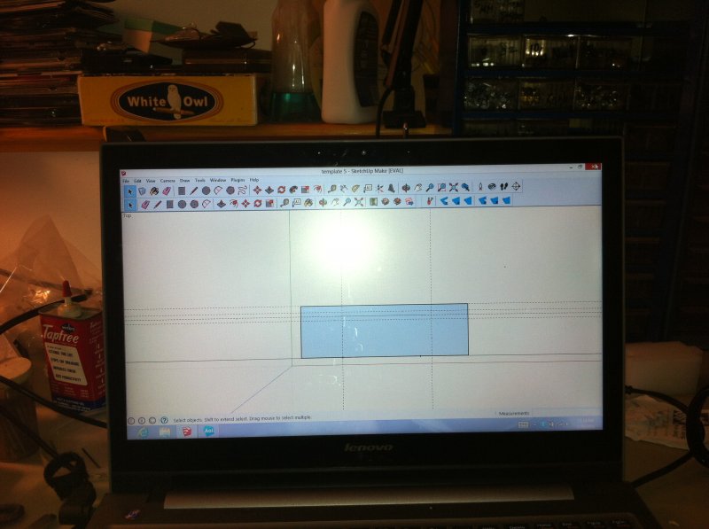

    I have gotten sketch up on my computer and was able to download and install sketchUcam. I have the tool bar with the seven tools. IMG_0349.JPG but nothing else. I watched the second Ox build video and the is a toolbar I don't have, I need it to open the preferences window. Maybe it is just hidden where do I find or download it. Thanks

    Hi @Greenman
    Check this out (seeing you are on a windows system)
    If the toolbar does not appear you need to enable the toolbar
    • Select View
    • Select Toolbars
    • Tick 'Phlatboyz'
    • Click 'Close'
    You will now have 2 new toolbars, the SketchUcam tools, and the Phlatbones tools.

    I just did that and I only see Phlatbone not Phlatboaz.

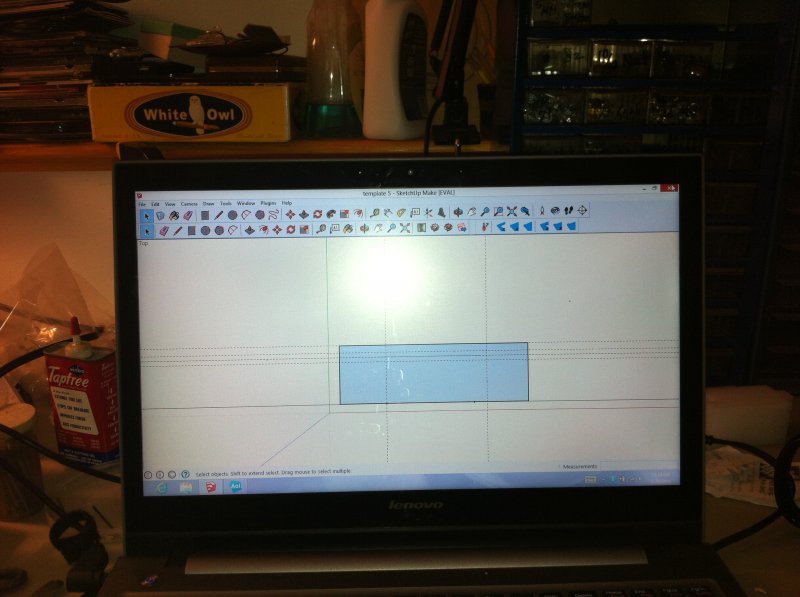

    From looking at the picture something has gone wrong with your install as you have the same tools repeated some how.
    Silly question but have your restarted the computer after the install?

    Ok so funny thing happened, I updated to sketchup make, installed scetchucam 1.1b and I'm now having the same issue.
    Phlatbones shows up and I get an error when opening sketchup make saying the strings of phlatboyz are corrupt ?
    Everything then loads and only phlatbones shows in the tool bar

    Ok here it is

    Right click on your Google SketchUp 8 fold an make sure you have permissions

    You da man!
    Ty
    I have no idea why that would do that as I install everything logged on as admin ? :confused:
    Anyway it's working, now to get my hands on the plate file and get them aluminum chips flying :D

    Good to hear Robert, but I cannot take the credit as there was a similar problem on the Phlatforum and a few of the guys there figured it out :) but all the same glad to hear it worked!
  12. David the swarfer
    3,361
    1,879
    in detail...link to how to set the permissions
