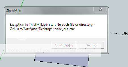

    Hello,
    I'm slowly entering the world of CNCs and while looking for the necessary software stumbled upon sketchucam.
    I installed the plugin on SUP 8, but have a couple issues.
    I saw this introductory video and followed along to make a simple square cut. I also changed some default settings.

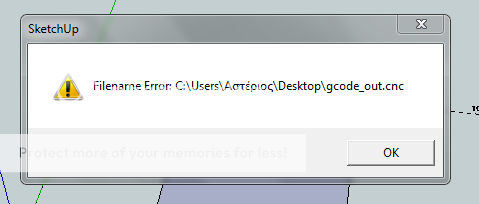

    When i click to generate the gcode i get this error
    and after clicking ok i get this error
    [​IMG] (retry and cancel, I'm Greek btw)
  2. David the swarfer
    3,361
    1,879
    You cannot use special characters in the file path or name, only 'ASCII' characters (in other words, no Greek characters).

  3. _3D_
    _3D_ New
    Jun 7, 2015
    It was so obvious. Changed it to D:\G-codes\ and worked like a charm.
