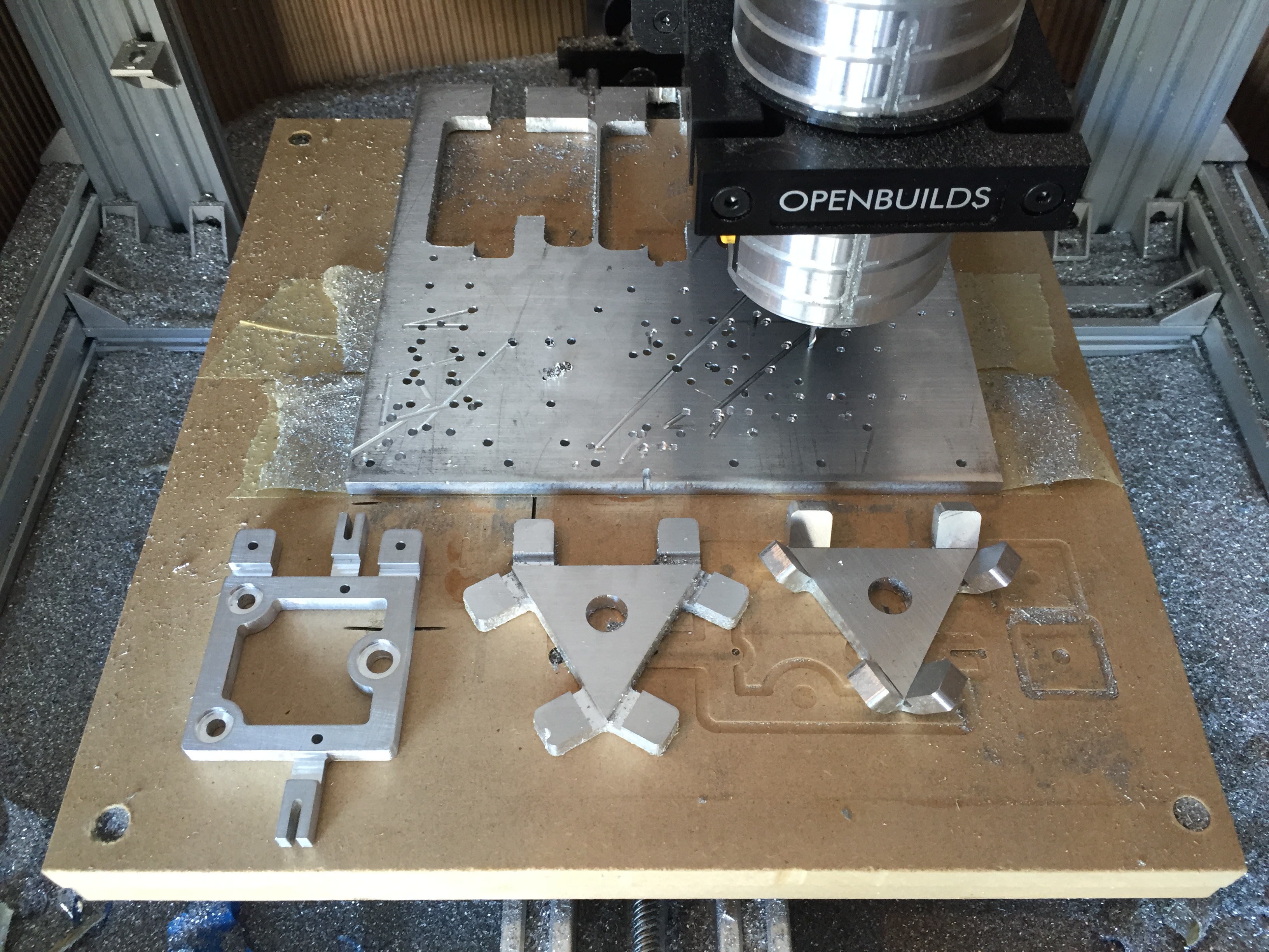

    Hi all -
    I want to share a great technique for affixing plates to C-Beam, OX and CNC routers. This has worked exceptionally well with 6.5mm aluminum plate.
    The following YouTube videos explain the technique well.
    Brad - www.UltiBots.com
    Modified C-Beam Bundle
    Dewalt 611
    Elaire 1/8" Collet
    1/8" Single Flute Carbide End Mill
    Workflow = Fusion 360 & Cam > Chilipeppr > Tinyg
    RPM ≈ 25,000 (dial setting 5)
    Feed @ 20"/min (508mm/min), Ramp @ 5"/min (127mm/min), Plunge @ 8"/min (203.2mm/min)
    Pocket cut = 0.25mm rough & 0.2mm finish, 3mm max stepover
    Bore cut = 0.2mm pitch
    Contour cut = 0.25mm rough & 0.2mm finish
