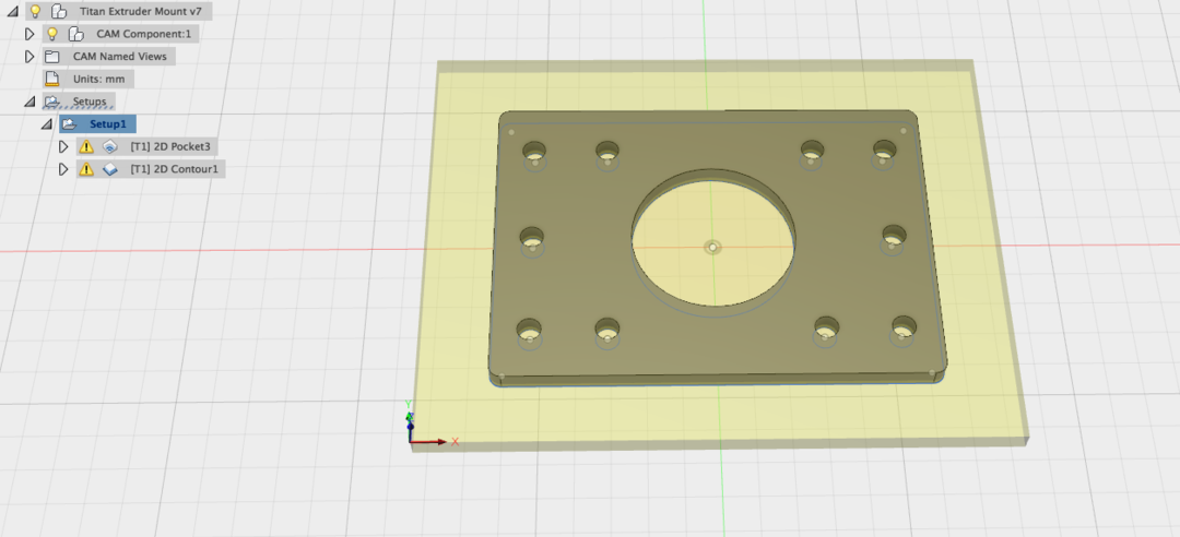

    I've been unsuccessfully attempting to cut aluminum on my new MiniMill.
    My setup is MiniMill with Makita RT0701C and 269oz in Nema 23s. I am using a 3/32 in carbide end mill from Kodiak tools. The part cuts perfectly in foam and 1/8" plywood. I am hoping to cut the final part out of 1/8" aluminum . So far what I have on hand is 1/8" 2024 T3 (I think - it's leftover from a plane project and I can't find any markings), but I have some 6061 T651 on the way.
    I am using Fusion 360 with the generic Grbl post processor. Here is the part:
    I am using pocket cuts for the holes, and a contour cut for the outside. I've tried both climbing cuts, and conventional (had better luck with climbing). One of the attempts (climb) forced the bit down from the collet some. The other attempt (conventional) just stopped. Both attempts ended with the first hole (the large one).
    I'm using the minimum speed on the Makita (~9000 rpm) and I think I used a feed rate of 800mm/min on the first attemp, but lowered it to 254mm/min on the second attempt (after consulting a feed/speed calculator).
    I suspect I was trying to mill too deep with each pass (0.5mm). But I have a couple of questions:
    1. My bit is ~2.68mm diameter and I had used a stepover of ~2.26. Does that matter on spiral pocket cuts? (I may try again this morning with 0.6mm stepover and 0.2mm depth/pass. However, that increases the machining time on this simple part to almost 1.5 hours - that doesn't seem right!)
    2. Am I correct that a climbing cut is better? (My endmill is 2-flute.)
    3. Am I correct that a "lowest" spindle speed is better?
    4. When cutting a "slot" in material (which is the case for the contour cut), does climb vs conventional really matter? I haven't made it to the contour in aluminum, but climbing worked fine in the plywood.
    Any answers or other suggestions will be much appreciated.
