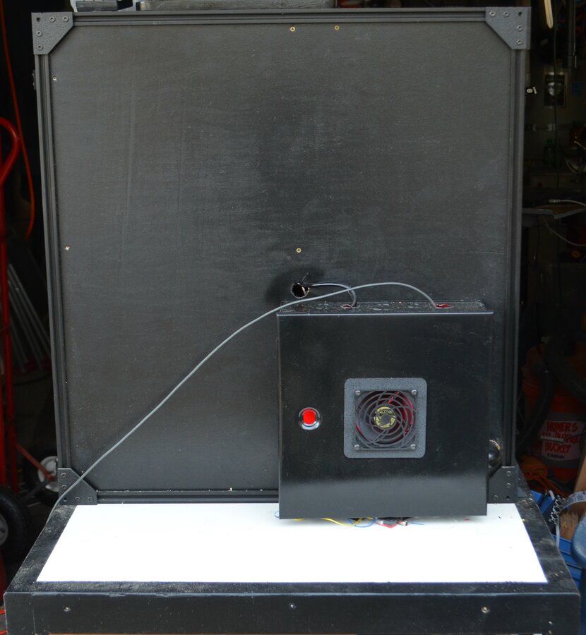

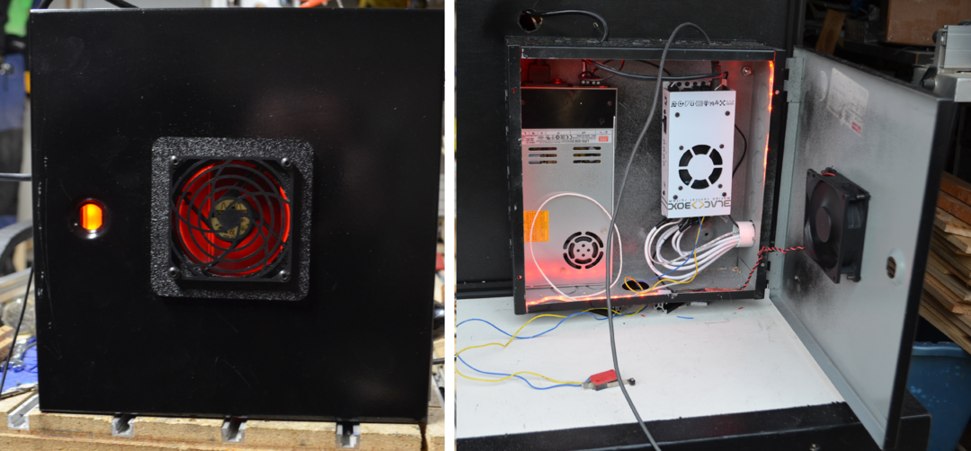

  6. Giarc
    2,923
    1,621
    I found a metal one at a store that sells used scientific and electronic equipment. I cut a hole in it and put a fan and lights inside. I also knocked out a few of the "knock-outs" on the bottom for air to get pulled in.
    Peter Van Der Walt and jda70az like this.

  9. Giarc
    2,923
    1,621
    I used one of the 24v power plugs. I have to admit, I cheated and that is why there are lights. I only had a 12V fan, so I calculated out how many LEDs on the strip would draw 12V and wired it in series with the fan. The lights use 11.97 volts and the fan gets the rest.
    Although it does contribute to the overall decibels, I do not hear it over the cutter. My fear was having both the power supply and Blackbox in a metal enclosure without a lot of ventilation. I am not too worried about the noise level because it is on my lathe which is used for carving, so each tool path is at minimum an hour. I just start it and head back in the house and come back out when I hear the router shut off.
