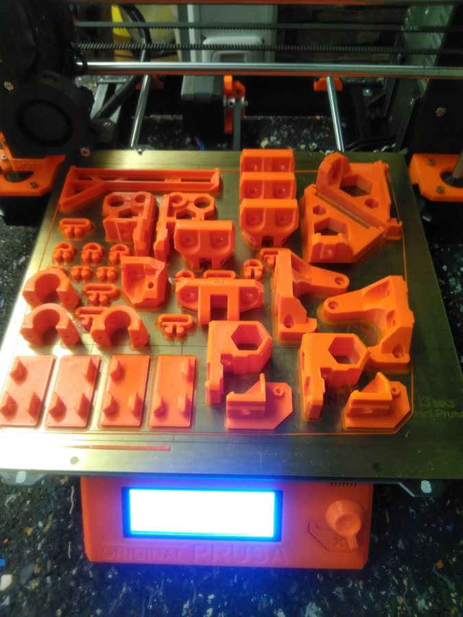

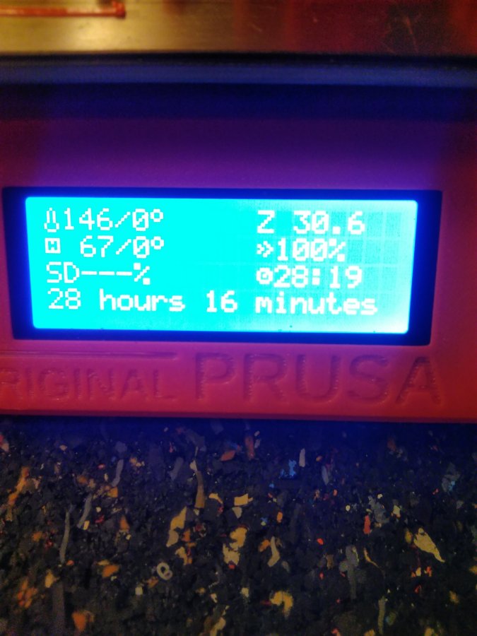

    21.5 hours, 78% done. Filament level looks good. Extrusion is arriving tomorrow. Very excited.
    Assembly has to wait until next week though. :cry:

    Printed Parts:
    • All in all I am clocking around 36 hours of printing for everything
    • I know there is a guide on the print settings, but here is what I used instead:
      • PETG orange from DasFilament.de
      • 0.15 mm layer hight for everything (optics matter! it's called "woman acceptance factor" :cool:)
      • 40 % infill, 3D honeycomb
      • 5 top/lower layers
      • 3 perimeters
    • Problems I got
      • bridging on the end caps. Not sure why. Might be some fine tuning required for this material.
    • Part list
      • I wonder if there are 2 end caps missing for the z-axis? And if so then there are 2 set screws missing in my order... o_O

    Awesome pic! I did not try to print everything at once because I was developing pieces by pieces...
    For bridging on end caps, maybe your Z height was just a bit too low. Do you have a photo?

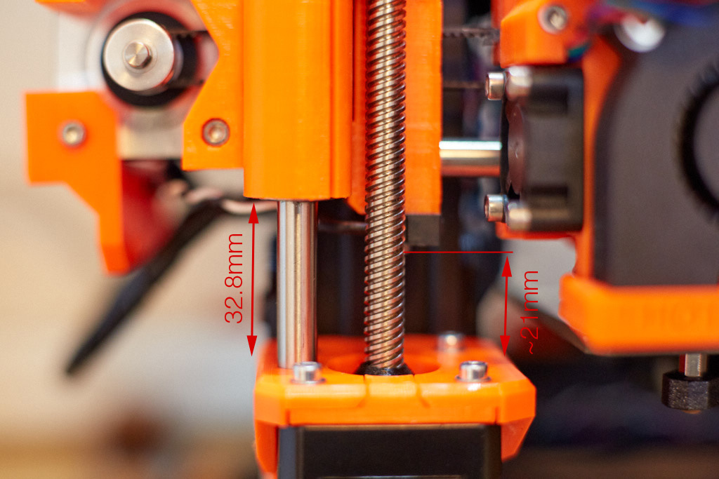

    I do not know when I will have time to start developing the linear rail for my upgrade but I really want them! If you come to a solution before me, please share :)
    Would you be kind to share the supplier link? I could add it to the store list here : prusa_i3_bear_upgrade/openbuilds_stores_list.md at master · gregsaun/prusa_i3_bear_upgrade · GitHub
    I think you were speaking about MK2.5 upgrade kit no (you wrote MK2s)? Can't wait to get mine!
    I am happy you like it and would like to build one. I did some measurements to help you (maybe you do not need to change anything) :
    Note that the 21mm takes end stop screws into account. Maybe you could try a MK3 clone instead, you will not have this end stop then...
    Also, top plate of Z motor mounts is 7mm thick (so 21mm becomes 28mm)

    You will need to increase a bit the position of Z motor mounts because the X/Y motors are a thicker. This is not really a problem, just be careful to align them correctly. Bonus, you will win few mm in Z axis as well.

    Nice! Just be careful, my Z motors are at the same position as the MK3, which is 1.8mm higher than MK2(s). This reduce the place for the coupler by 1.8mm. I do not know at which height the Z motors are on the Haribo/Zaribo.
    Let me know if you need some measurements on my upgrade and/or original MK2s/MK3
