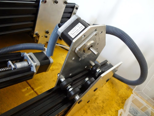

    The first version using V-Slot, with leadscrew, that don't work well. I cound't get both Y leadscrew in perfect parallel, and the nut I got have a lot of backslash.
    [​IMG] [​IMG]
    Use only one 8080 in the X axis, made the gantry very flexible.

    [​IMG] [​IMG]
    Any suggestion and criticism is welcome!
    I look forward to feedback from you, and now take the opportunity to leave some questions.
    What thickness and aluminum alloy you recommend to make the plates?
    My priority is to be the easiest alloy to machine, because I'll do them by myself after building a larger machine. Forgot to mention, but soon I will receive a three-phase 0.8kW spindle. I hope it's enough.
    For now I found local suppliers that have the following alloys in this thickness range:
    1100, 1200, 5052, 7075.
    And lastly, how will I sell these machines, how can I do stress tests, and determine the useful life of components?
    Which components tend to wear faster?

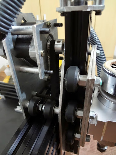

    I'm having backlash trouble.
    I Did some movement testing through the arrows of UniversalGcodeSender, making some squares, with each line always moving every 5mm.
    Unable to accurately measure the size of the gaps, but they are much visible.
    I'm beginning to suspect that could be a little angle between the entrance and exit of the belt on the pulley. Or do you think the angle is enough?
    I stretched the belts as much as I could with pliers, and apparently I could tighten the screws without twisting/rotate the belts between the V-slot slot.
    What other causes can generate backlash in systems with belts?
    Apparently they really is GT2 (2mm pitch), becausa the machine was uncalibrated if they were MXL.
    Can be low quality belts / pulleys?
    With so many things in mind, I could only perceive that great backslash when I started testing PCB milling.
  12. Mark Carew
    2,750
    2,423
    It looks more like it could be missing steps or even the pulleys slipping on the motor shaft.
    Make sure your pulleys are one solid unit with the motor shaft and that they do not have any play and see if that helps.
  13. Tweakie
    Tweakie OpenBuilds Team
    Moderator
    Jan 18, 2014
    784
    326
    My guess would be that the pulley is loose on the x axis motor shaft or that there is some lateral movement in the Z axis.

  14. Jeferson SImoes
    Mar 7, 2014
    16
    Hello guys
    I redesigned the plates, so now the belts "mesh" (touch? I don't know the word) more tooth of the pulley. And I changed the belts/pulley for new ones. Now I'm sure I got the GT2. It's really good now. I already received the GT2 3mm setup from OB last week, and soon I will replace for it, as soon I get some light/slim Nema 23 steppers. The heavies I have I will use in the big machine with the spindle and VFD.
    To be perfect, only when I got the 6mm aluminum plates. This 1/8" plates that I cutted, it's ok, but is not the ideal.
