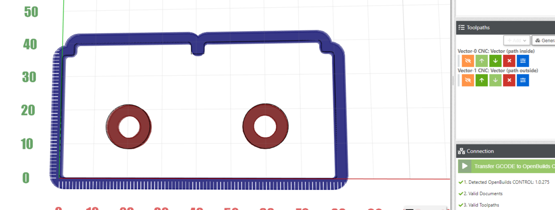

    I recently built a workbee 1050 with black box for use with a hypertherm 45xp plasma cutter for cutting small parts for my hobby shop.
    Both the workbee and plasma cutter seem to work perfectly from an accuracy and control standpoint when I import drawings from the openbuilds sample library.
    I was planning to use Fusion 360 to generate drawings for the parts I need, and for the time being, at least, export those drawings into the ob cam to generate the Gcode to send to OB control, because I know those last two steps work perfectly.

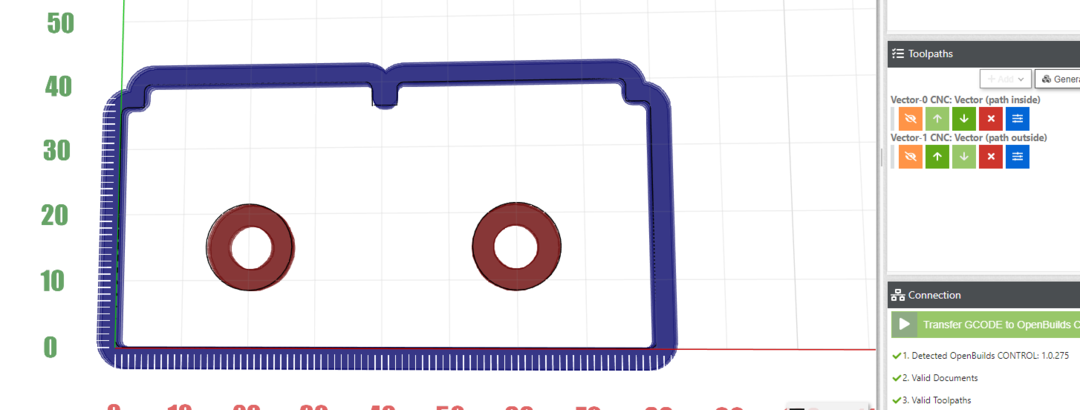

    I have run into a problem importing the DXF file from Fusion 360. When the document shows up in the OB cam, it is always inverted, and in the negative x and y coordinates compared to where it was in Fusion. When I go to move it to the positive quadrant in cam, it gets highly distorted,rendering it permanently unusable. Following through any relative strings in the CAM forum, I have found that the solution to this recurring problem seems to be:
    A) ensure you export as a DXF r14 file .
    B) explode your splines into poly lines
    C) export your DXF from fusion 360 into something like Librecad then export it to OB cam in the correct DXF format.
    However for solutions A I don’t have a clue how to achieve this in Fusion 360. For Solution B , I don’t even know what a spline or polyline is, let alone know how to convert one to another. As a side note, I have also noticed that I have no ability to view the 3D capability in ob cam using windows pc, but I have observed 3D view when viewing using iPad. Any help on this would be greatly appreciated, before I resort to trying yet another software.( solution c)0

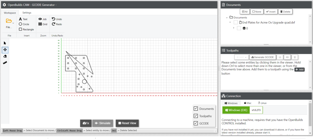

    I just decided to try out qcad for generating my part drawings and creating DXF files. I was happy to see that qcad gives you a great variety of DXF file types to save in, including dxf R14 format.

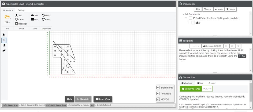

    I was really disappointed however, when I loaded that dxfr14 file into OB cam and I STILL get the same issues as the DXF from Fusion....just like above, the part shows up inverted, in the negative x and negative y quadrant, and when I try to move it into the correct location it becomes permanently distorted.
  16. Peter Van Der Walt
    14,042
    4,123
    Post the file, so we can check whats wrong
  17. Dave 20B
    Dave 20B New
    Nov 24, 2020
    18

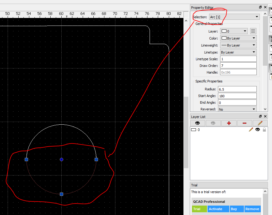

    Ran it again, and this time it came into the correct position, and it was moveable, but all the arcs are partially missing.
    I tried to explode arcs to polylines?..., but it wasn't really easy to find that in qcam, and I'm not sure it worked, or if it did any good.

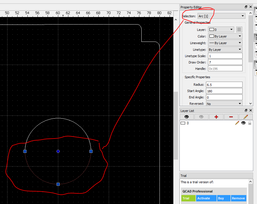

  18. Peter Van Der Walt
    14,042
    4,123

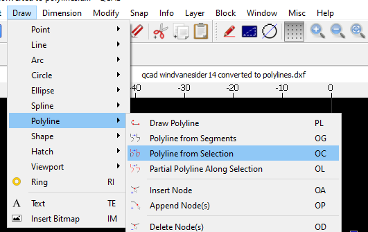

    So I opened the DXF in QCAD
    Clicked one of the missing arcs, and its still an "arc" (not a polyline):

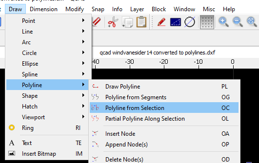

    So, I selected everything, went to Draw > Polyline > Polyline from Selection
    - then I fixed the 2mm Y offset by going to Modify > Move and Rotate
    - exported to DXF R14 again (attached)

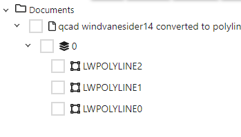

    - it works fine in CAM now:
    as the source tree shows, everything is now polylines too:

    Thanks Peter!.. I was trying to use "modify" rather than "draw" to get those arcs converted to polylines, and I guess it only worked in a few places.
