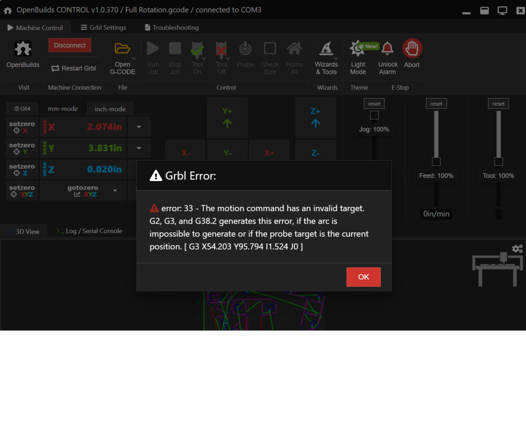

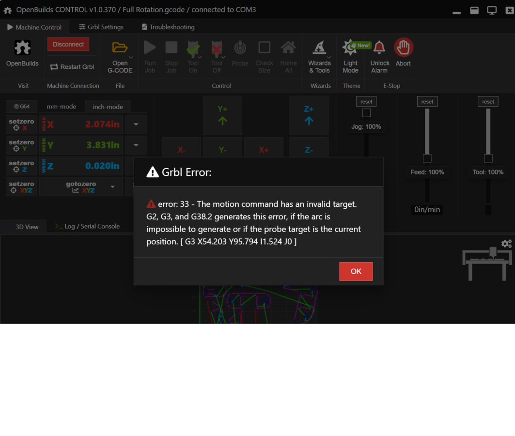

  14. Louis Gagnon
    Aug 6, 2023
    Hello
    I Have a similar problème
    When i do the set zéro after probing de z-axe that have a limites switch.
    Then i start the job for the first holl it go's à the good height after the sencond holl it go's up and after that up again en up and up and block it dosent do the probing for each cut that it suppos to do
    What could be the problème ? I follow the step up in this post but still not working
    And get this alarme
    Where is the Gcode

    G90 G94 G17
    G21
    (Plasma pierce height 1.5)
    (Plasma topHeight 0.5)
    (Operation 1 of 1 : 2D Profile3)
    G54
    (Plasma cutting with GRBL.)
    (Using torch height probe and pierce delay.)
    G0 X52.679 Y97.318 F1524
    G0 X52.679 Y97.318 Z15.24
    G38.2 Z-100 F150
    G10 L20 Z-2
    G0 Z1.5
    M3 S1000
    G4 P0.6
    G1 Z0.5 F1524
    G3 X54.203 Y95.794 I1.524 J0

    However, I cannot see any actual error in the arc coordinates so I have to think of other possible causes and all I have come up with is a USB communication error caused by EMI.
    It is a plasma cutter after all and that line of code is where the arc has just burned through and has just moved closer to the material.

    I did the update of the GRBL post-prossesor to V1.0.37 and a redid the job. But got the same error and this time de plasma cutter was off.
    the relais clicked so the plasmas could start(power off plasma is off) that for me is ok
    The wire hare all shielded Z-switche motors and i did instal a EMI on the power sorce of the control box. juste to try to eliminate the fréquence.
    here are my setting on Fusion360 im running out of ideas

    it does use the probe routine, 42 times in fact.
    lets look at what the gcode is doing
    Code:
    G0 X52.679 Y97.318 Z15.24       ; go to initial position, 15mm high
    G38.2 Z-100 F150                      ; probe down till contact
    G10 L20 Z-2                               ; set Z offset
    G0 Z1.5                                      ; set Z to 1.5 high from the probed+offset position
    M3 S1000                                  ; torch on
    G4 P0.6                                     ;  penetrate delay
    G1 Z0.5 F1524                           ; reduce Z hegiht to 0.5mm
    G3 X54.203 Y95.794 I1.524 J0  ; perform lead-in arc, 1.524mm radius as specified in your parameters
    G1 X66.877 Y95.794                  ; straight cut
    G3 X68.401 Y97.318 I0 J1.524  ; lead out arc
    M5                                              ; torch off
    G0 X68.401 Y100.341                ; move to new position
    X55.754 Y105.379                      ; move to new position, in 2 parts because it is avoiding the existing cut
    G10 L20 Z-2                              ; set offset
    G0 Z1.5                                     ; raise a little
    M3                                             ; torch on
    G4 P0.6                                    ; delay
    G1 Z0.5 F1524                         ; lower
    G1 X55.196 Y105.238              ; start cut, about 0.5mm move
    G3 X55.649 Y103.131 I1.28 J-0.827  ; leadin arc
    X59.081 Y108.443 I1.716 J2.656       ; cut circle
    X55.649 Y103.131 I-1.716 J-2.656   ; cut circle
    X57.756 Y103.584 I0.827 J1.28      ; leadout arc
    M5                                                ; torch off
    G0 X56.072 Y146.018                     ; move to start of new cut
    and so on
    technically speaking there should be a retract after the torch off commands and I will check later as to why there is not. This may be causing a problem because the torch is only 0.5mm away from the plate when the probe starts, may be even less if the plate is not flat and happens to be a high spot .
    Please fake the home (if you do not do this already) and run it again, Z home should be at the top of travel.
    I also note that the G38 commands do not have P words and while the default is to change the current WCS if there is no P word, maybe they really are needed so I will add that to the postprocessor tonight
