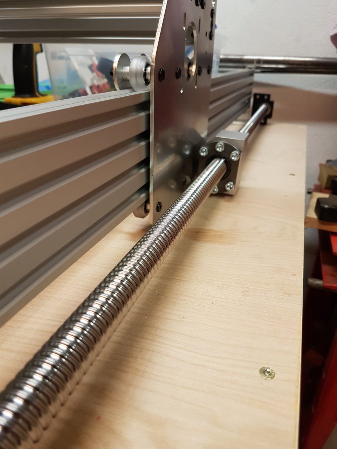

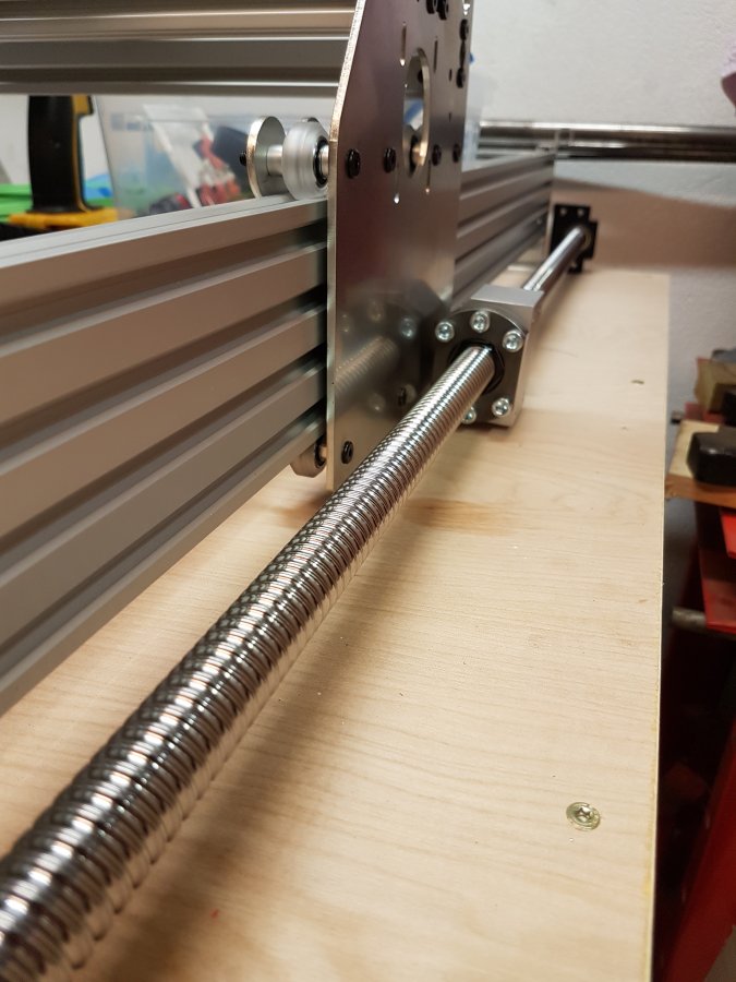

  13. LarsTveito
    Mar 4, 2017
    19
    23
    Got some ballscrews in the mail today, so now I can start to make brackets for attaching them. Started with the spindle mounting plate. Had to extend the wheel holders, so I can fit the ballnut mounting housing behind the v-slot-plate. Added some ekstra holes on top so I can add an extra set of wheels if necessary later. Still a little bit nervous about the weight of the 2.2 kw spindle, it seems heavy compared to the extrusions that are going to hold it.
  14. LarsTveito
    Mar 4, 2017
    19
    23
    Starting to testfit the ballscrews, need to make brackets for the ends, and spacers and mounting bracket for the gantry nut.
    GrayUK and Bad Sequel like this.
  15. LarsTveito
    Mar 4, 2017
    19
    23
    Made spacers for the ball-screw mount to gantry. 47.5 mm long, 18 mm diameter. Next is a mounting plate. Made them quite big since they are going to transfer loads sideways. This is for one side, then I need four more for the other side. I'll try to make a short video of how I made them later.

  19. LarsTveito
    Mar 4, 2017
    19
    23
    20171231_153621.jpg 20171231_153616.jpg 20171231_153611.jpg 20171231_153607.jpg Slow progress on this one, been a while since last update. Started mounting ballscrews now, gantry is almost finished.
    #19 LarsTveito, Dec 31, 2017
    Gunnar Norum likes this.
  20. LarsTveito
    Mar 4, 2017
    19
    23
    Some more progress, mounted the spindle mount today. Had to make my own version of t-nuts, took some 10x2 mm brass flat bar, cut to length, drilled and tapped for M5. Then aluminum t-profile to bolt into the mount and to the t-nuts. The t-nut goes all behind the mount in one piece, so both top and bottom nut is connected to the same flat bar. Drilled the holes in the t-profile oversize by one mm, so I can adjust the spindle clocking.
    You can also see one of my limit-switches there.
    GrayUK likes this.
