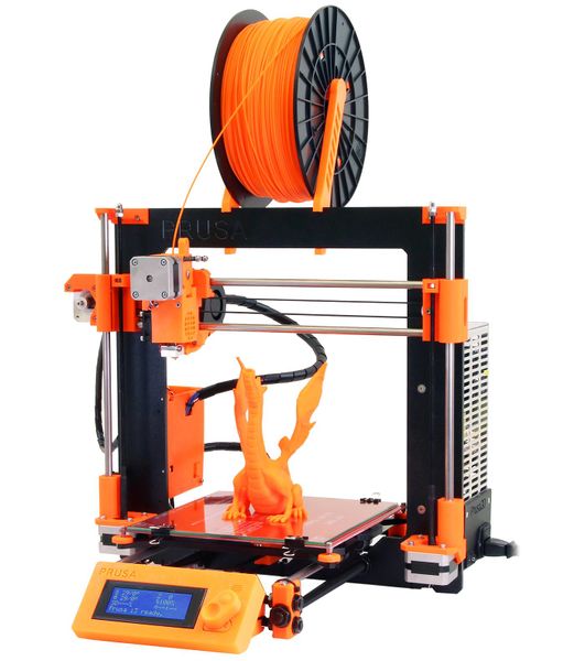

    I'm a complete noob to 3d printing, and Naurdan's comment definitely echoed what I've been wondering. I have a technical electronics background so a friend asked me if I could help him assemble a kickstarter 3d printer he got that has sat in a box in pieces for far too long. That was about three weeks ago and I've been swimming in the 3d printing sea of terms since. So...
    As an attempt to figure what the heck it all means, I'll try to answer the question and reference what I find along the way.
    Serial Stackup vs Parallel Manipulator Systems:
    One of the first distinctions between a lot of the common printers is if the motors are arranged in a serial stackup or a parallel manipulator system. CoreXY - RepRapWiki In a serial stackup system, at least one motor is being moved by another motor. In the photo below from RepRap Machines - RepRapWiki, you can see the serial stackup arrangement in the Prusa i3 design. On the Prusa i3, the y-axis moves the bed. The x-axis motor is being moved up and down whenever the z-axis motor runs. The x-axis motor is seen on the side of the machine, with the shaft pointing toward the camera. The two z-axis motors can be seen at the bottom on each side of the vertical frame. Even though there is an additional motor in middle of the photo near the print head, this motor drives the extruder and doesn't effect the axial movement of the printer.
    With respect to the OpenBuilds categories, the serial stackup arrangement seems to be seen primarily in the Cartesian Style Bots.
