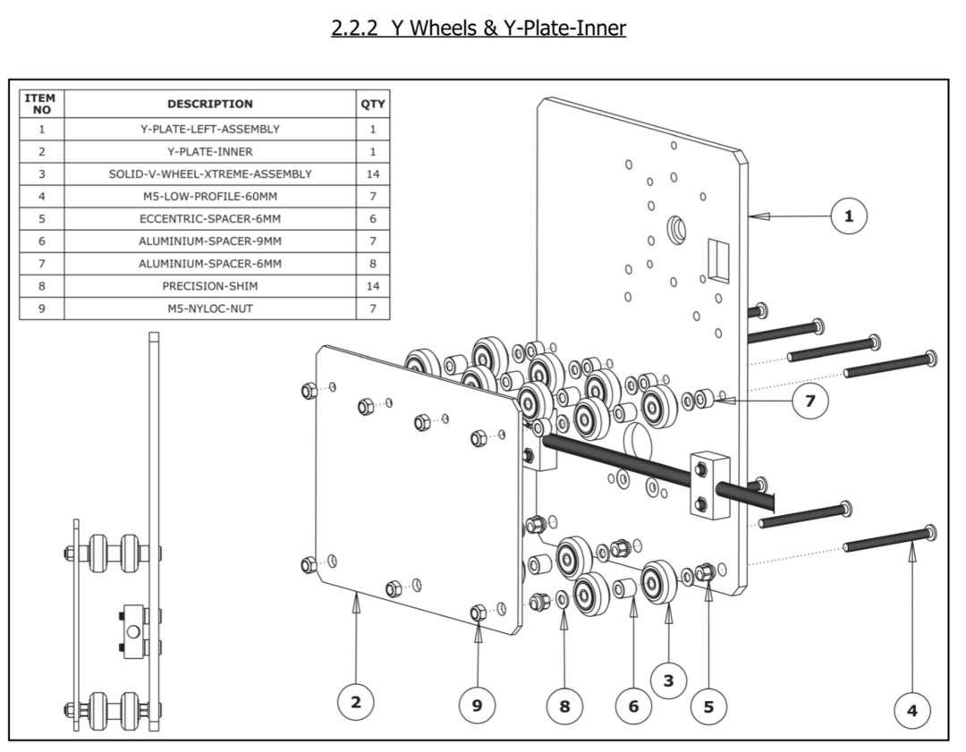

  16. Travis Macken
    May 9, 2016
    Ok, the build video is wrong on the first Y plate. He says to add the eccentric spacers, shim, then a regular 6mm spacer then a wheel, then 9mm, then wheel then spacer then other eccentric spacer. There shouldn’t be any regular 6mm spacers on the bottom. Just eccentric, shim, wheel, 9mm spacer, wheel, shim, then 6mm spacer. The top one should have the 6mm spacer, shim, wheel, 9mm spacer, wheel, shim, then 6mm spacer.
  17. Craig Hollabaugh
    Craig Hollabaugh Well-Known
    Aug 18, 2014
    50
    61
    Travis, are you referring to figure 2.2.2 in the WorkBee-Screw-Assembly-Manual.pdf?
  18. Travis Macken
    May 9, 2016
    I’m referring to the youtube setup video. It’s incorrect. But yes, that is the part.
    Where is the assembly manual at? Is that the Ooznest manual?
    #18 Travis Macken, Jun 21, 2018
