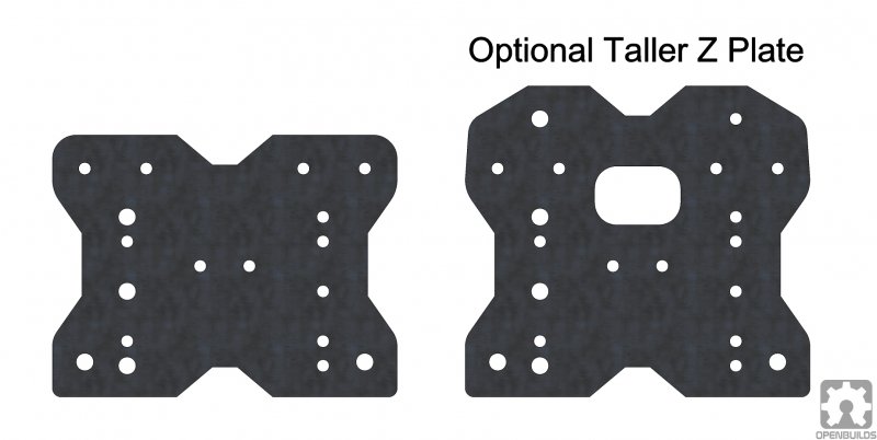

    Hey guys just a quick plate update for the OX build.
    Chris Laidlaw pointed out that he found an error in the front X plate (Z) that left the center spacer block hole off a little (Thanks for the feedback Chris)
    It was not enough that it would keep the mounting screws from going into the spacer blocks, but from what we tested it did make them tight so we thought better to fix it.
    While at it we did a little redesign/mod of the Z plate and made it taller so that one more set of wheels could be fit to it at the top. This was a request of (I believe) Serge here on OpenBuilds.
    My brother has a similar set up on his machine and it does make for a much stronger Z axis. The idea here is you could build the Z axis longer and leave the lead screw at the longer 300mm length to make up for any space the extra set of wheels takes up. This will also give you a longer Z axis which is nice option to have as well.
    Please note if you do this mod you will need to upgrade your spacers for the Z plate to metric so that you can build out the new wheels to the 20mm Spacer Block thickness - not a big deal to do but just thought it should be mentioned.
    Be aware that this plate is untested as of yet, but logic dictates it should work :rolleyes:
    OpenBuilds Team want to thank everyone who has contributed to the OX build as it evolves into a community driven design that is awesome!
    Hope this helps, have fun with your builds!

    Lol! Mark I JUST started a conversation with you about this issue. I'm the one who brought this issue to Chris Laidlaw's attention. My Z-axis thru-holes are out of tolerance enough to bind the mounting screws to the point that the second one won't thread in at all. If I try to wrench on it, it WILL cross-thread the block, I can guarantee that. I am using his aluminum V-slot Spacer Blocks. What are the Part Store blocks made from? Maybe they are more forgiving than my aluminum spacer blocks, as I haven’t seen anyone bring up this issue here in the forums.
    Now I want that Taller Z-axis plate!

    I'm still measuring 40.6125mm center to center on the thru-holes in the NEW .dxf file in LibreCAD. On BOTH versions of the Z-axis X plates. :confused: Edit- I'm ordering V-Slot Spacer Blocks from the Part Store on the suspicion that it is my spacer blocks that are out of spec with the intended design. The threaded holes are spaced at 40.00mm center to center where I believe they a supposed to be 40.6125mm.:

    I told Mark "I received my first report of an issue with the X shaped Z axis plate/Spacer block holes not lining up today".
    Tho i did find that the spacer holes were not symetrical on the X plate and did not all line up with the spacer block holes on both the original dxf files and the latest dxf files.
    Thanks to Nugz for finding the issue and Thanks to Mark for quickly verifying the issue and starting work on correcting the dxf files!

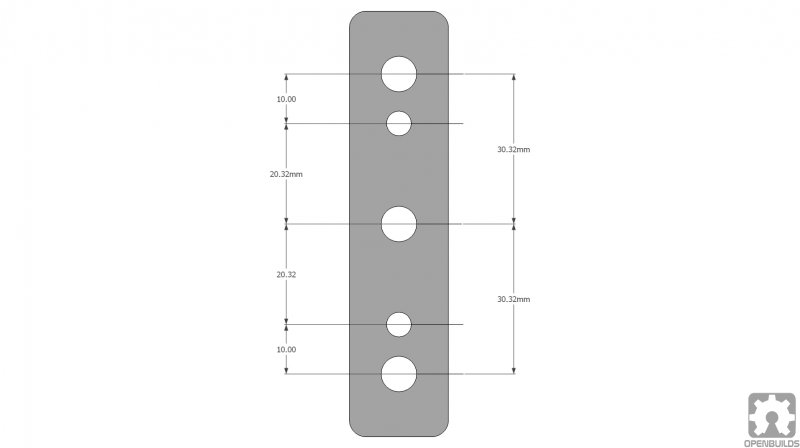

    The V-slot spacer block drawing that was on this Openbuilds OX CNC site in the r3 zip file on 4/27/14 is 40.00 mm on both sides of the center hole... (see attached)
    I assume the parts in the Openbuilds store are made to this Openbuilds drawing.
  17. Nugz
    Nugz New
    Oct 8, 2014
    58
    That's the source of the problem Chris. You are making Spacer Blocks that do not mate to the X-plate that you are also making. The error is in the Spacer Blocks. Like you said, the CAD file was on the site but is no longer available. All I'm trying to do here is find the source of the problem and correct it. I'm not trying to place blame. This is all Open Source and we are an Open Community. We are working from each-others work and mistakes will sometimes happen.
    Your parts are, otherwise, beautifully machined, and obviously accurate to the file. I don't mean to come off harsh, but if that file is wrong you need to take the steps to correct it before sending more bad parts out.
    -Nugz

    Hi Chris,
    Here is the spacer block drawing that should help
