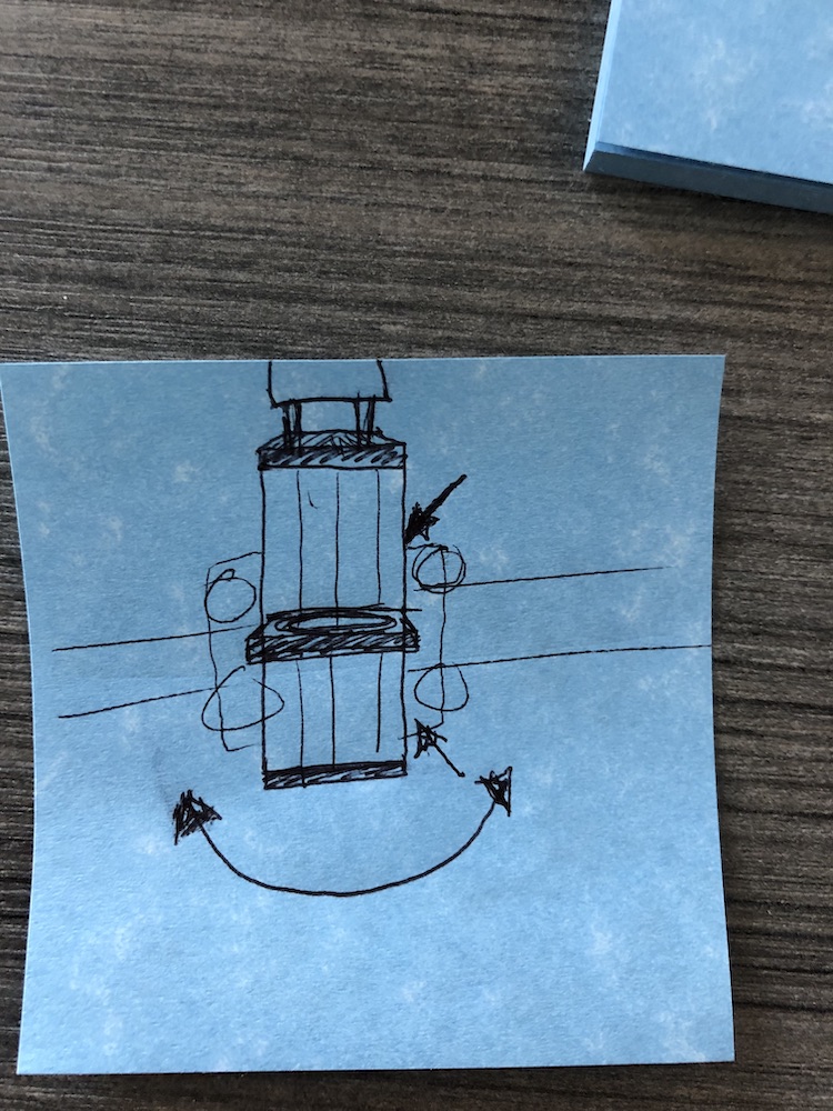

    I've got a little rotational play in my Z axis and not sure what the best way to resolve it is. If I grab the spindle mount from the front there is a little clockwise and counter clockwise movement that is not getting fully eliminated by adjusting the concentric spacers. They wheels are in as close as they get and it dials it out a bit, but there is a good millimeter of movement here.

    What plane/s is/are the movement/s in? Difficult to put into words but if you are looking from the front of the machine does the router mount/ bottom of Z axis move left to right, back to front or does it rotate when looking from above? Like you I can't think of anything obvious apart from eccentric adjustment. Is this a new machine or has it put in many hours of use?
    Alex.:(
    Just spotted your spoiler board thread - apologies in advance for asking a really obvious question, but are you sure you assembled the V wheel correctly with shims between the bearings?

    Crude drawing below, but this is a new machine, and I do believe it was all done correctly, but I will triple check.
    The drawing is more of an after thought, but the arrows pointing to the the wheel contacts is where the problem is. In reality the wheels are in the channel but even with the eccentrics fully closed they are not making full contact. They are centered into the channel spacing wise just fine. The bottom of the z-axis moves left and right radially because the wheels are not fully engaging into the slot channel. My first thought is the top left v-slot wheel is flawed and the wrong diameter, but that doesn't seem to be the issue.

    The plate is out of spec. Please contact the parts store for a replacement.
