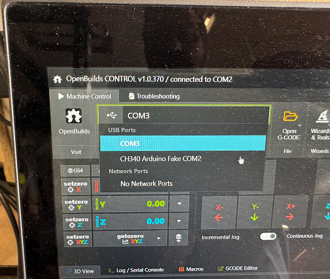

    Is it possible to get Control to remember the last USB port used? I’m getting a bit tired of opening the pick list each time I power my machine on.
    #FirtWorldProblems
  5. dJOS_500
    dJOS_500 Journeyman
    Jul 16, 2022
    262
    119
    For those wondering what I mean, my control board is on virtual com port 2, but control defaults to the real com port 3 every time.
    Even junk like candle can recall the correct port, so it’d be nice if OB Control could too.

    JS Macro, autorun,
    Code:
    $("#portUSB").data().select.val("COM3")
    (might need to wrap it in a setTimeout that waits for the portlist to be populated)
    or even save yourself all the clicks, just add an autorun JS macro that executes
    Code:
    selectPort("COM3")
    Then when control starts up it will autoconnect (untested, but basically thats the stuff JS macros are for)

    Code:
    setTimeout(function() {
        $("#portUSB").data().select.val("COM3");
        selectPort("COM3")
    }, 5000); // 5000 milliseconds = 5 seconds
    And then just make the macro
    David the swarfer and dJOS_500 like this.

    I understand your point, however when you are working on a CNC re-build and there are multiple controller power cycles and firmware rebuilds, Control not automatically defaulting to the last port used, gets annoying fast.
  20. dJOS_500
    dJOS_500 Journeyman
    Jul 16, 2022
    262
    119
    Thank you, this plus the delay code from @Peter Van Der Walt worked great! :thumbsup:
    Code:
        $("#portUSB").data().select.val("192.168.10.22")
        selectPort("192.168.1.120")
