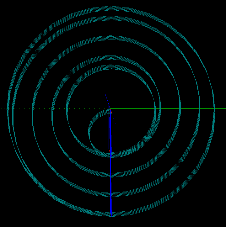

    Here is a diameter first mode hole drill operation. 0.6mm bit, 2mm diameter hole, 33% step over
    Note that this cycle (diameter first) first does a helical bore to full depth at 2x bit diameter (you don't want this) before doing each layer out to diameter (you want this) in a spiral.
    The spiral is really 2 half circles, start point (Y) to Y+stepover/2 then to Y-stepover for each rotation.
    The other option in SketchUcam is depth first, where it will do a helical bore to full depth for each step outward. Neither is exactly what you want, but the idea here is education not a complete solution (-:
    Exactly how it generates the hole boring depends on the bit diameter, hole diameter and stepover%
    if hole diam < 2x bit diam then it always does depth first (that is why I had to do a 2mm hole here, 1mm always comes out as helical bores to depth.
    if stepover is less than 50% then it always helical bores first, never plunges, deeming this a 'for hard materials' operation
    if stepover is > 50% then it will plunge the center of the hole to depth, deeming this a 'soft material' operation. SketchUcam was born in the world of cutting foam board to make RC airplanes so this makes sense in that world, you can cut foamboard at pretty much any rate you like, plunge with almost any tool etc, very forgiving. Titanium, not so much (-:
    Note that there are limits as to what you can do in Sketchup at the small end of the scale because it does internal comparisons to 0.001 inch, if the difference between numbers is less than that then they are regarded as equal. SketchUcam code does comparisons to much less than that (I had to write my own function for it), but now and then the Sketchup comparison will mess you around.

    I did some parts in plywood recently where I climb milled to depth and then did a finishing pass at full depth and conventional direction, leaves a very smooth surface.
    No, it is a 'plunge bore' operation, specifically for making round holes.
